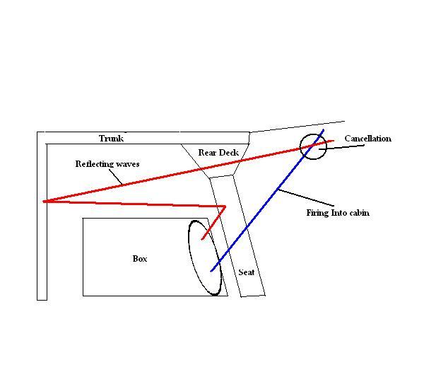

This is what I mean

^ now how would you get the angles right??
Just try and match the angle of the baffle as best you can with the enclosure front panel. So, in other words, it's best to seal the trunk from the cabin with a baffle matching the angle of the front panel of the enclosure. That'll minimize the reflecting waves from even making the trip back to the lid. Pretty easy thing to test too. If you can open and close your trunk without effecting the sound on front firing woofers, you got it right. If opening the trunk makes the bass louder, that means there are waves that were reflecting and cancelling in the cabin and now that you've opened the trunk they are headed toward the moon and stars instead of bouncing off the deck.
