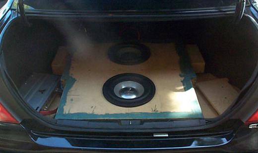

Fiberglassed into spare tire well. 4.1 Cubic feet, 2 Dianmond Audio TDX104's tuned to 35Hz with slot ports.
