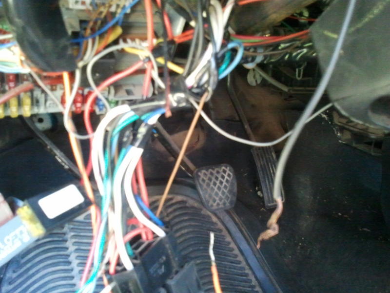

ID:	85120I have a 95 civic.my wife has been using the car while i was away working.she left the lights on & killed the battery.she attempted to boost the car & reversed the cables.then she proceeded to boost it again the correct way,tried to start the car & the alarm went off & she couldnt get the alarm to shut off.so what did she do then?she ripped the wires out of the alarm siren.ffs

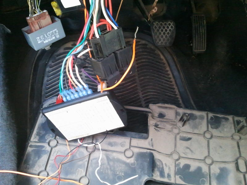

She could not get the car to start so she tried to disconnect the alarm unit from under the dashClick image for larger version
Name:	2013-05-08 10.05.29.jpg
ID:	85121.i cannot figure out where the orange,black,white/black stripe wire were attached?the car still will not start?

Find the company that made the alarm, go to their website. Look for installation instructions.
Also, try www.the12volt.com
If this was on a customers car, I'd probably recommend to remove the aftermarket stuff and return the car to stock.
