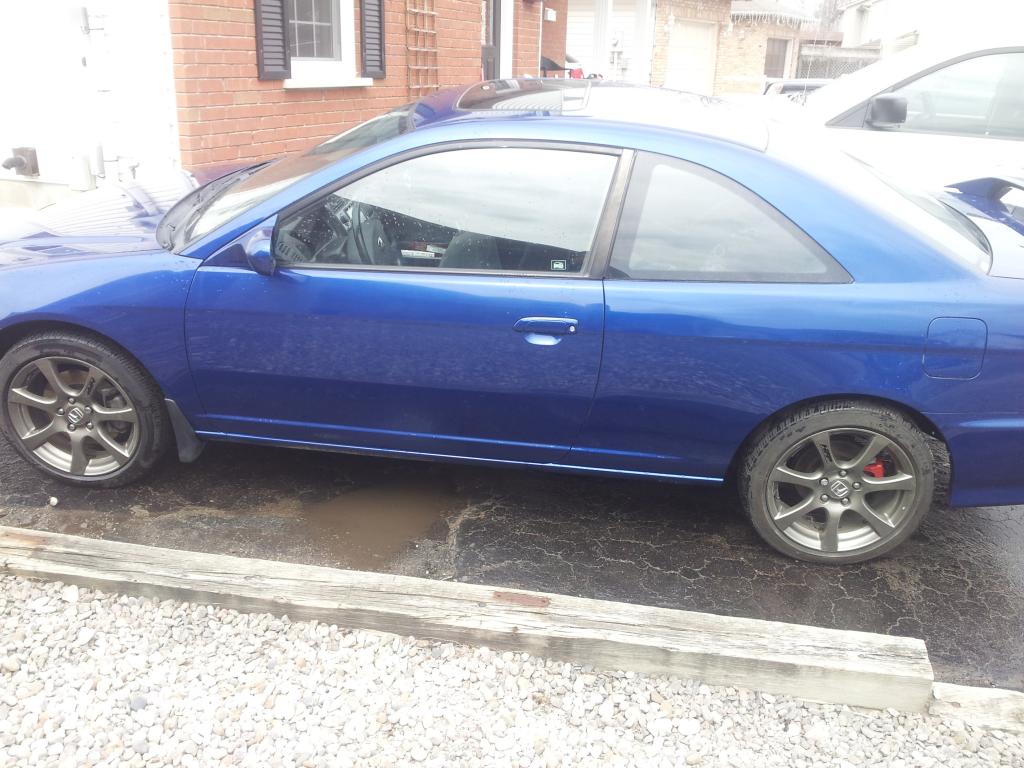

Here is my braking setup. RSX type "R" rear brakes with RSX Type "S" front brakes:
Massive improvement in braking. I don't run Hawk pads but if I did I'd probably get even better performance.
There is no cheap big brake kit for EM2s except the RSX type "S" swap. All the aftermarket Willwood and Brembo kits are 1-2000 dollars or more.
