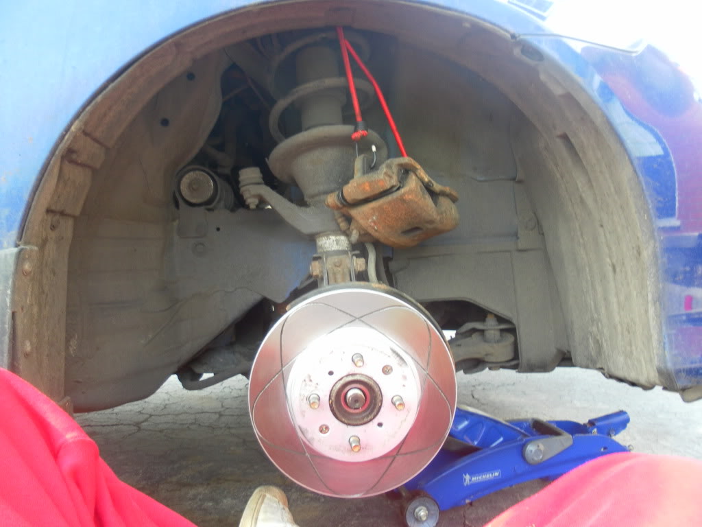

thinking of doing something to make the car stop quicker and shorter, and at same time to get them too cool down faster. any tips or input? if i upgrade the disc to i have to get new calipers and break pads too or how does it work?

1. when you drill/slot the rotors, you significantly lose surface area of your rotor. that means less surface area for your pad to come in contact with your rotor. this means less friction, less braking power, and a loss in braking performance.
so why do all the higher end cars have them? because they run 15" rotors and we run 10." they can throw some drills/slots in there and not sacrifice surface area.
2. properly drilled/slotted/veined rotors are meant to take and cool high heat...ie racing applications. if you drive on the streets and do occasional spirited driving, you will rarely push your rotors to its limits. and if you ARE serious about racing/autox, then your stock rotor is extremely insufficient and you need to think of investing in a big brake kit.
3. drilling/slotting the rotors weakens the structure. period. there is no argument in it. its basic physics. when you look at the cars that have proper drilled/slots, you will notice that the thickness of their rotor is MUCH thicker than ours.
google it, you'll find plenty of failed rotors that were drilled.
and this isn't exclusive to our little rotors. There have been guys with the IS-F that have cracked their oem rotors on the track. google and you shall see.
now, for street applications for your civic, if you want to go with slotted/drilled rotors, then thats fine. chances are you will not push those rotors to their limits and if you got a decent brand, you'll be ok.
and if you want them simply for looks, no one here is to tell you otherwise because its your car, your taste. hope you have learned something and hope i have cleared some confusion concerning drilled slots.

RSX type "S" :

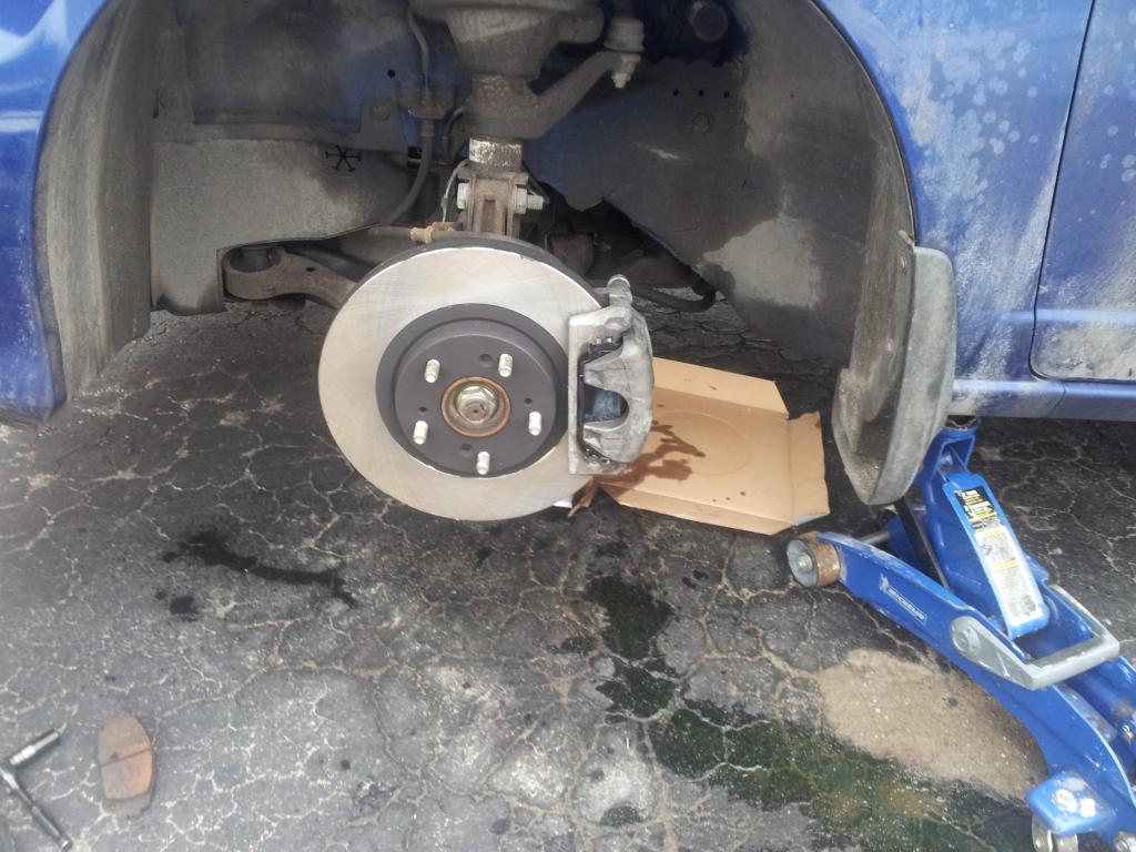

vs. RSX Base:
Huge upgrade. Your going from a 10" rotor to 11.8". These swaps can be seen on Kijiji for as little as 300 dollars. It is a big job though, and you need new rims+tires. Still cheaper than a BBK.
