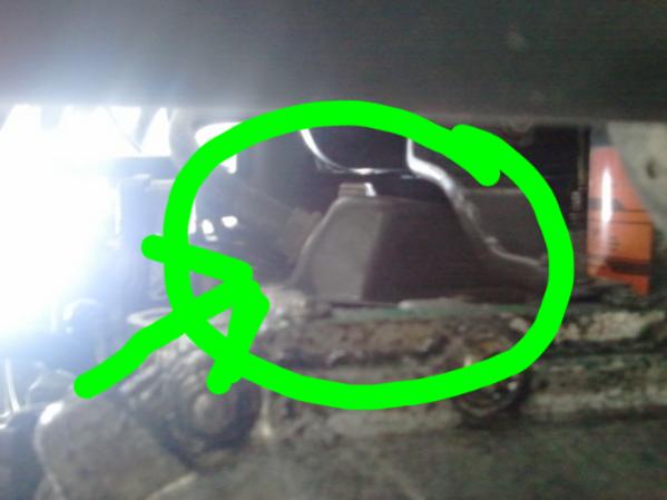

where is it ??? a diagram be handy unless its easy to find lol
It's on the back of your block. Lay under the car, with front of the car above your stomach, head under your IM, look up. There should be a hose going to the back of your block. Heres a pic...

Originally Posted by SpdySylvrEX
Attachment 82292
thanks will have a look tomorrow - hopefully wont be raining
