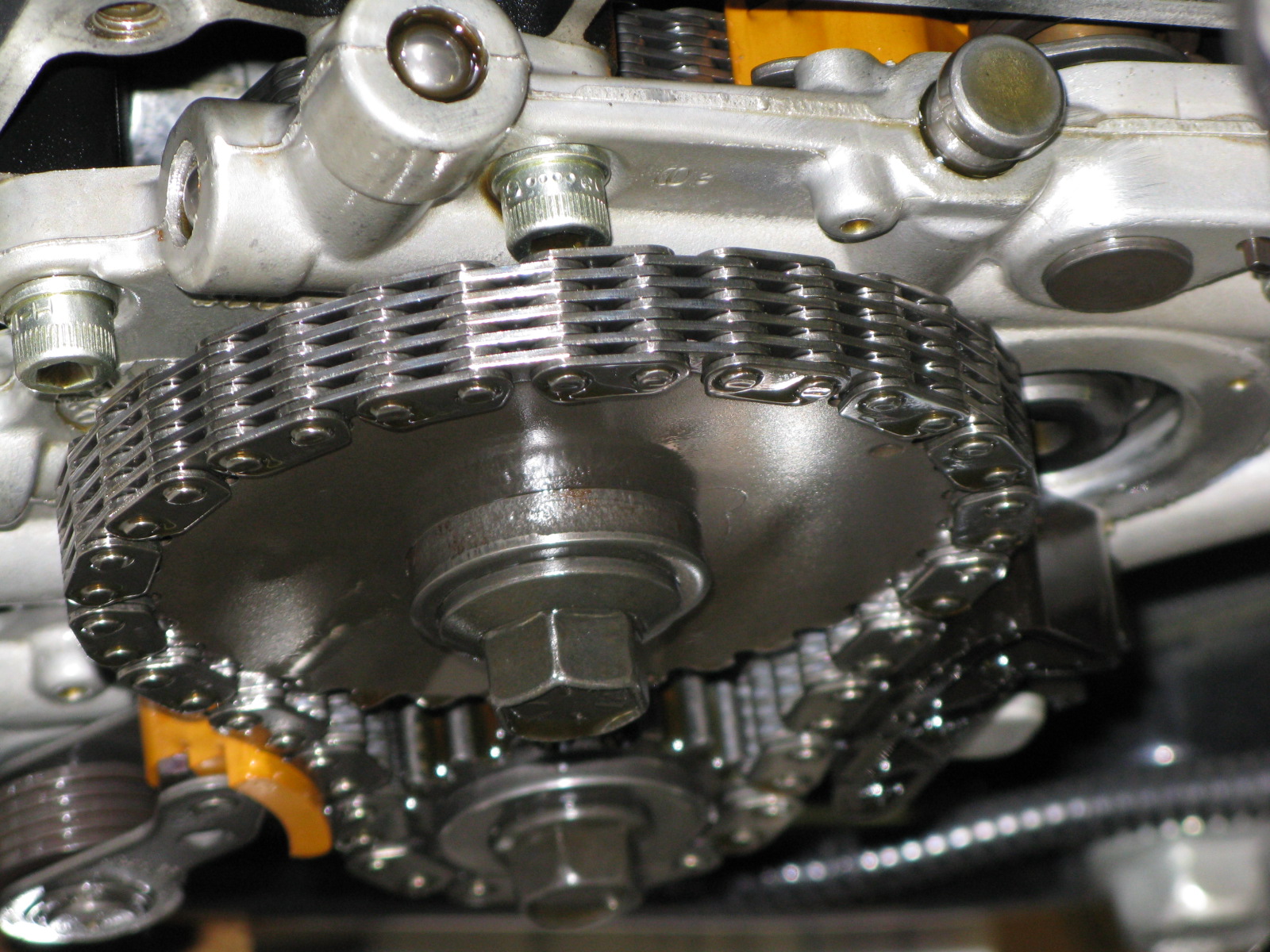

I've been running Mobil1 V-Twin 20w50 in mine, all 3 holes.
So far so good. A little bit of fuzzys on the magnets, not a bunch. Only 20k on it though. It seems like I barely ride it anymore.
I've read the twin cam 88 can eat up cam chain tensioner pads? Have you checked into the Harley forums?

Mine at 30K. Hardly worn. Only problem I have had in 45K was alternator spline went.
Name:	TENSIONER 30K HARD TO SEE.JPG
ID:	87996   Click image for larger version
