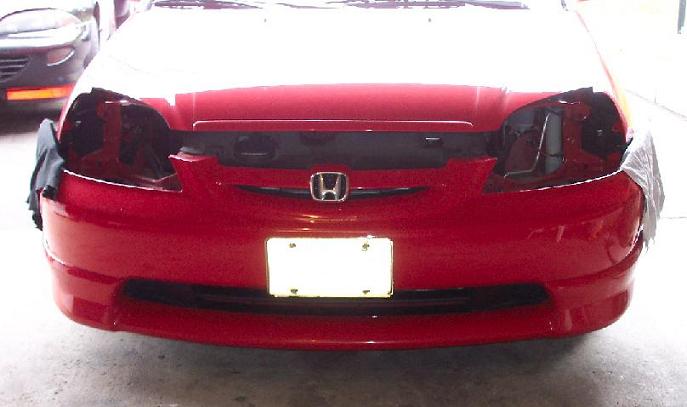

Ya you'll be fine. Quick tip. Leave the clips underneath the car attached and they will support the weight of the bumper. Now it wont fall on the floor. Wrap a rag around the edges of the bumper so they don't scratch your fenders, like in the pic.
