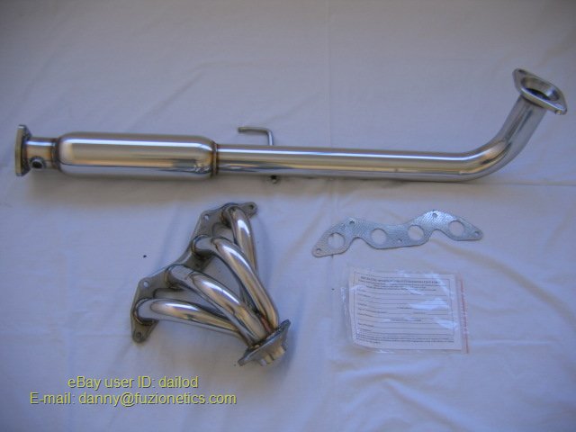

I have a cuple questions about my 02 civic lx CUPE!
#1) Where in the world can i get headers and not loose my cat converter???????????????????????????????????? if i get everything (headers,downpipe, hiflow cat, etc etc) for EX will it work???
http://www.fuzionetics.com/ebay/H2001ES2_3.jpg
CHEK IT OUT

Let me try to explain the exhaust question...im tired of telling everyone about suspension lol its that time of the day.
You cant get headers and not lose your cat (you can have an aftermarket high flow cat welded into your new exhaust but whats the point). The problem is that on the LX, the cat is built into the header, unlike the EX. However, you cannot swap an EX header to an LX to remove the cat because its not a direct swap, I believe the EX header is shorter than the LX one. This means a few options
1. keep it stock...many users here have said that they did headerback exhausts and noticed nothing
2. do an EX exhaust swap...does nothing, and youll have to extend your o2 sensor wire to accomodate the cat being further under the car.
3. Swap an LX header into your header's place and lose the cat, have to make a simbox or o2 sensor defouler, and the only company that i know that makes this is OBX and has questionable quality
4. swap an ex header and performance exhaust...still wont have a cat and have to extend wires and such
i dont feel like typing the rest but you get the idea...if you want sound, get a muffler, or an intake. if what i heard about the "performance gains" is correct, its a great waste of 600 dollars and just adds to your mod list for talking purposes.
My buddy had a car like mine with an exhaust, and he lost low end power, the only gains were about 4500-5000rpm. If thats the RPM you drive around in, you dont deserve an exhaust, a car, or a licence. Thats just my opinion on the whole thing. I am getting a twin loop muffler put on my car, hell itl sound and perform the same as almost any other system out there for my LX.
GL!

Re: Lx Owners Please Help!!!
Originally Posted by uruguayanboy
3. Swap an LX header into your header's place and lose the cat, have to make a simbox or o2 sensor defouler, and the only company that i know that makes this is OBX and has questionable quality.
wut do you mean by having to make a simbox or o2 sensor defouler???
well if you have a cat, emission gasses will be different coming out than without one, and since the ecu recognizes the catted signal, itl throw a CEL code right away...that means no pass for inspection. a simbox im not familiar with but i think it electronically turns off the CEL code or changes the reading.
a defouler is basically an extender you use to move your o2 sensor out of the pipe so its still plugged in, but not completely submerged into the pipe, so it only gets to read some of the exhaust gasses, and thinks there is a cat present. here is what a defouler looks like
Look at this second picture. You can see there is still something that looks like a cat, but it looks like something was rewelded so im assuming it was either cut and gutted, or a high flow has been put into place. you can see that the defouler has moved the sensor out of the pipe so some gasses still flow onto the sensor, but not enough to make it think there is a high flow/missing cat, so everything is fine and dandy.
Any other questions, feel free to ask
