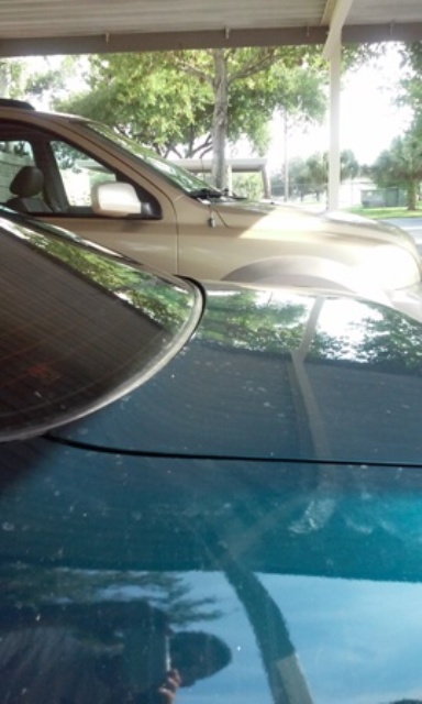

I noticed the trunk lid is slightly raised on each corner nearest back window:
1) Is the trunk lid supposed to make contact (compress) with the trunk seal?
2) Is it possible to lower the latch and adjust rubber lid bumpers to create a tighter seal?

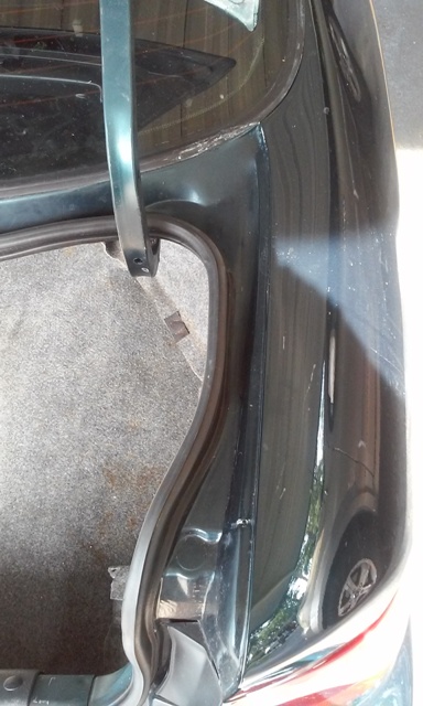

My son sat in back seats (folded down) with flashlight while I poured water all over rear window, trunk lid, over lights, bumper and trunk vent outside area.
No leaks anywhere else except both driver and passenger side drain channels (shown in previous pics).
Seems leaks definitely seem to start near rear window..most likely due to rust or poor seal repair during prior ownership,
I brought it back to the body shop and the owner agrees.He told me to bring it in tomorrow and he will crawl into trunk while I water it down.. to pinpoint leaks. He said he has a guy that will lift the glass and reseal for $140. While glass is out body shop owner will do repair if needed. The driver's side proximal drain channel under the rear window doesn't look rusty at all.. he lifted the rubber trim a bit around that area and it looks good. However, it leaks about half-way down the channel which is most likely at the seem area. I know there is clear seam sealer ..is there paint-able seem sealer? The body shop owner is from Honduras and there is a bit of a communication gap as I don't speak Spanish and his English is good but, I am not sure if he fully understands all my questions and statements. He's a very nice guy and I am confident the leak will get resolved.

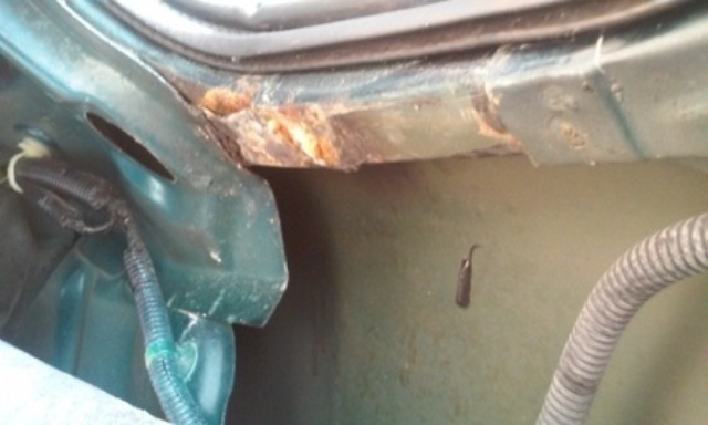

Here's a few pics of my car:

Old Sep 9, 2015
Re: 1997 Civic EX Coupe Trunk Leak
Yes, but you need to talk to a bodyshop person or supplier.
Bodyshop stuff is not my area, wrenches and paint don't mix well for me.
I let those people work their magic in their own shops.
Pic 4 looks crusty like whatever water has been getting in was running across it.
Another sign it's leaking from the rear seal..moving along that beam underneath the drain channel above. Time to break-out the Ospho http://www.ospho.com/ squirt gun.

I took it to him and he climbed in the trunk while I ran water over rear window and trunk. He saw the leaks and is convinced it leaking under the trunk seal and not rear window seal. He advised me to get either a new seal, junk yard seal in best shape I can find, or use removable. pliable sealant on the inner track (that mounts on the metal lip perimeter) of the current seal. I am not convinced that's the issue for the sides drain channels but, will make it a starting point.
After he climbed out of the trunk I ran water slowly over the rear glass while trunk lid was open. Near the middle of the drain channel that runs closest and parallel to the rear window the water skipped over that drain channel and into the trunk. I pointed out the trunk being possibly misaligned and the corners that are lifted up, as well as my concern that the lid is not compressing the seal. He agreed and used a sledge hammer (holding it close to the weighted end) and tapped from underneath along the drain channel that runs closest and parallel to the rear window while using his left hand to support the lower rear window/rubber trim on the topside. It bent that entire area up uniformly and resulted in the seal making contact.
For the driver's-side (side) drain channel I am positive the small leak is coming through the seam and I will coat that with seem sealer. The passenger side is yet to be determined and as stated I will start with trunk seal... any recommendations?

Yesterday, I applied the 3M seam sealer to the driver's side drain channel and to a couple small areas on the metal lip the rubber trunk seal seats on. New trunk seal installed using 3M super weatherstrip adhesive. Still leaking on both sides though, driver's side channel leak is significantly smaller.
I chatted on-line with a 3M technician and he said that the weatherstrip adhesive will not adhere to the seam sealer and I cannot rule out those small spots that water may be getting through. I will pull the seal from spots and remove the seam sealer and reapply adhesive in hopes it will stop the leaks..yet, I have my doubts. When I lift up a bit on the new seal all around the perimeter it feels firmly in place, even on the small spots with seem sealer underneath.
Pretty sure water coming through the rear window seal (polyurethane) and dripping down under the metal lip the trunk seal seats on.. thus, making it appear that the trunk seal is the problem. I also noticed that water is dripping long after I turned the hose water off. On the plus side the new trunk seal has cured or lessened previous trunk rattle. This is frustrating to say the least. It is an 18 year old car so I guess it's not unexpected but, seems like somewhat of design flaw .. kinda like the the (under) seat adjustment bar being closer to the center rather than the door....lol.
