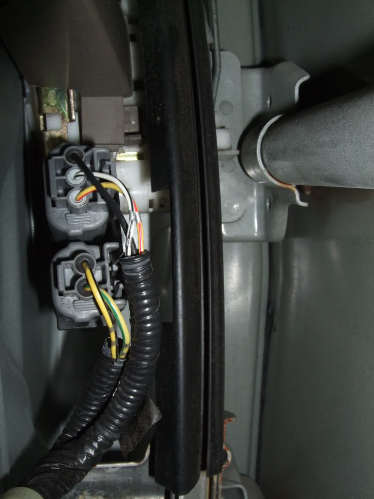

1. I tested my actuator with a testlight plugged into the clips that lead to the actuator (Didn't have a actual test light, so I used some 12v LEDs that I had laying around)
Clips gave a light, so I figured the actuator motor was blown (Since no sound was coming from the driver side lock when pressed)

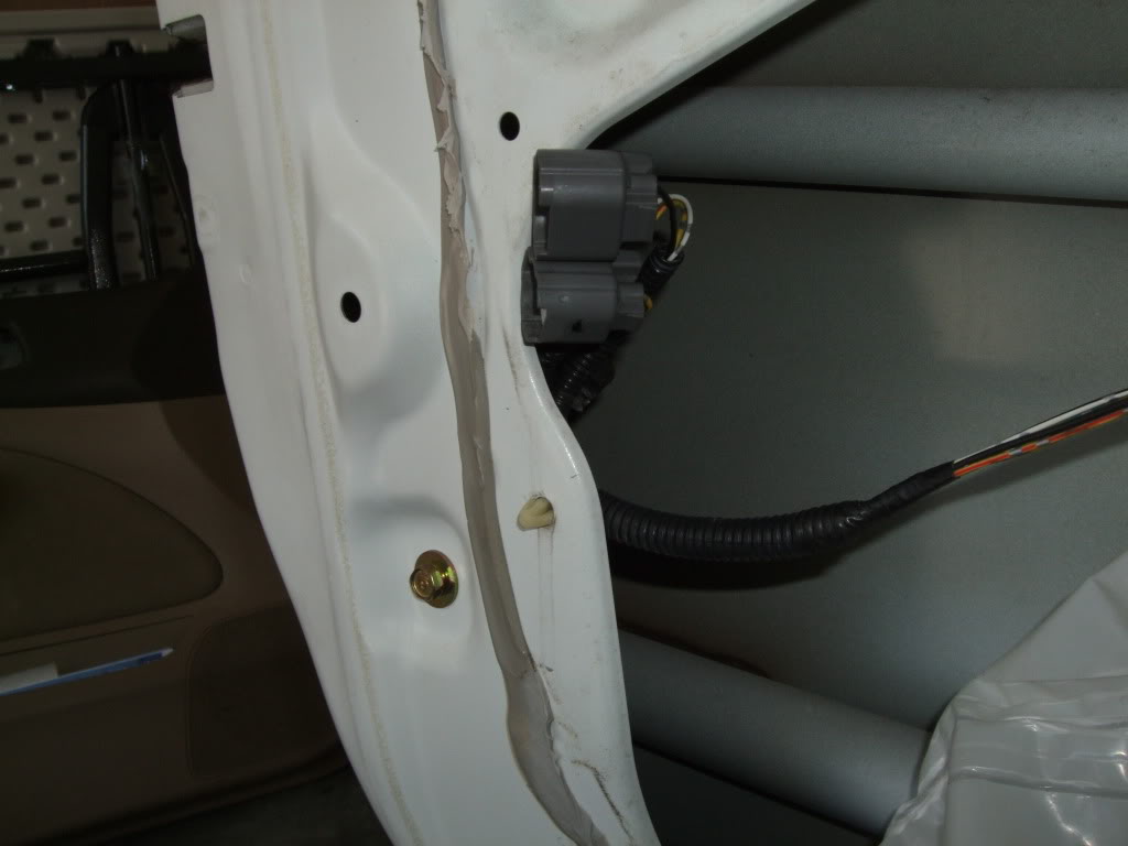

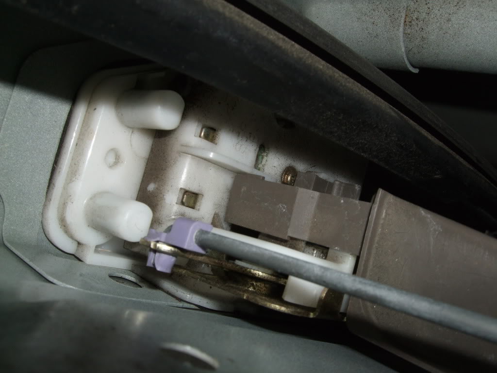

4. Took off Door panel, and plastic guard, rolled up window to expose the actuator and clips
5. I unplugged the clips, removed that white clip that held the cables to the door, and removed the 10mm bolt

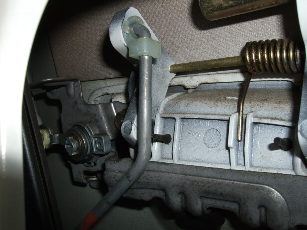

6. I then removed the rod that lead from the inside door handle to the actuator (by taking a picture, i could see from the inside)
7. Then I removed a second rod that lead from the outside handle to the actuator (this rod was a B**** to pull out, because it had a stub at the end, i pryed it out eventually with 2 screwdrivers)
8. And then i removed the last rod that lead from the door lock to the actuator (its the one all the way in the back)

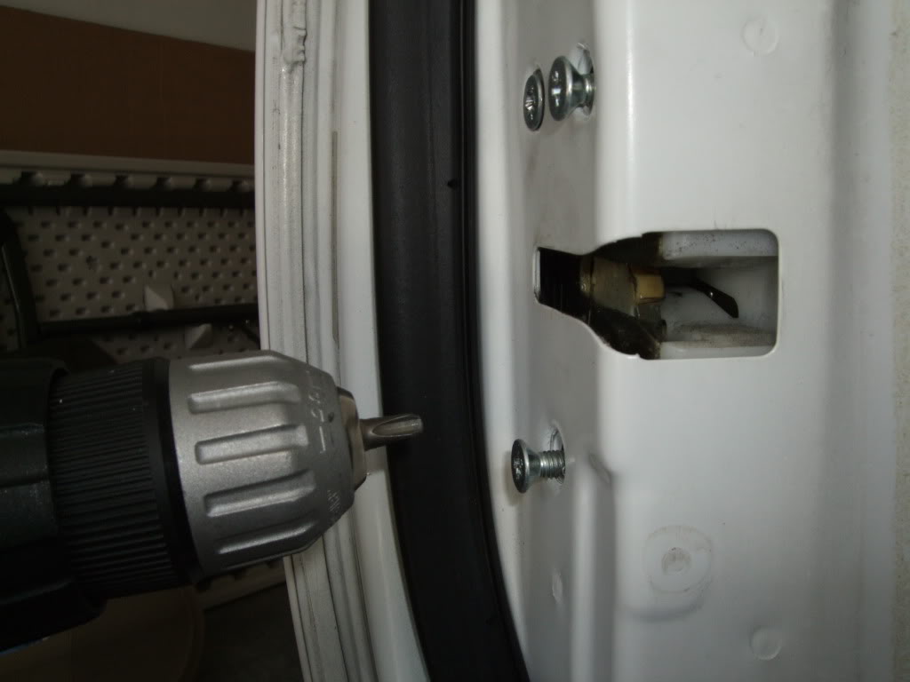

9. Next, I removed the 3 screws on the side of the door that held up the actuator (These were VERY tightly screwed in, and i stripped some of the first screw, so i went and found the BIGGEST phillips head bit i could find in my toolbox, got my drill, and unscrewed it. They were so tightly torqued in that I couldnt remove them by hand)

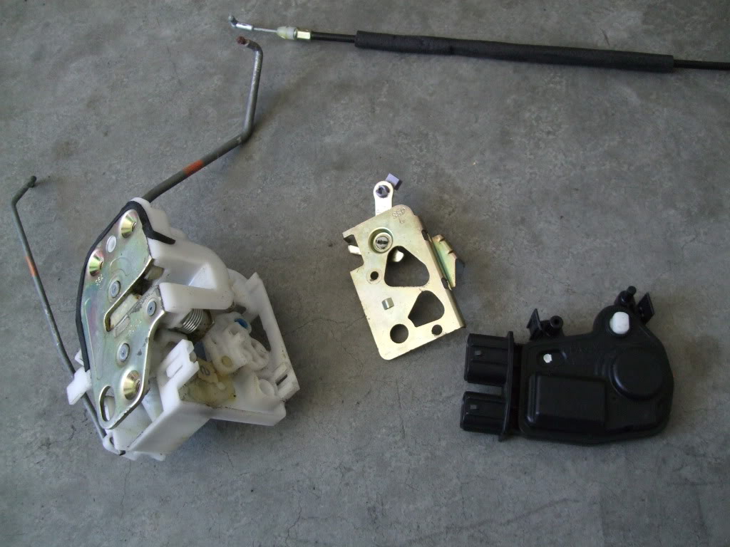

10. Moved window railing out of the way, and pulled out the whole assembly

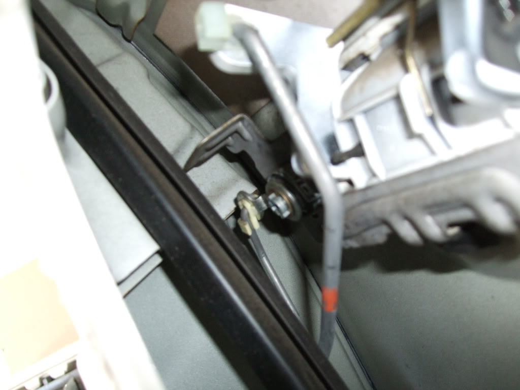

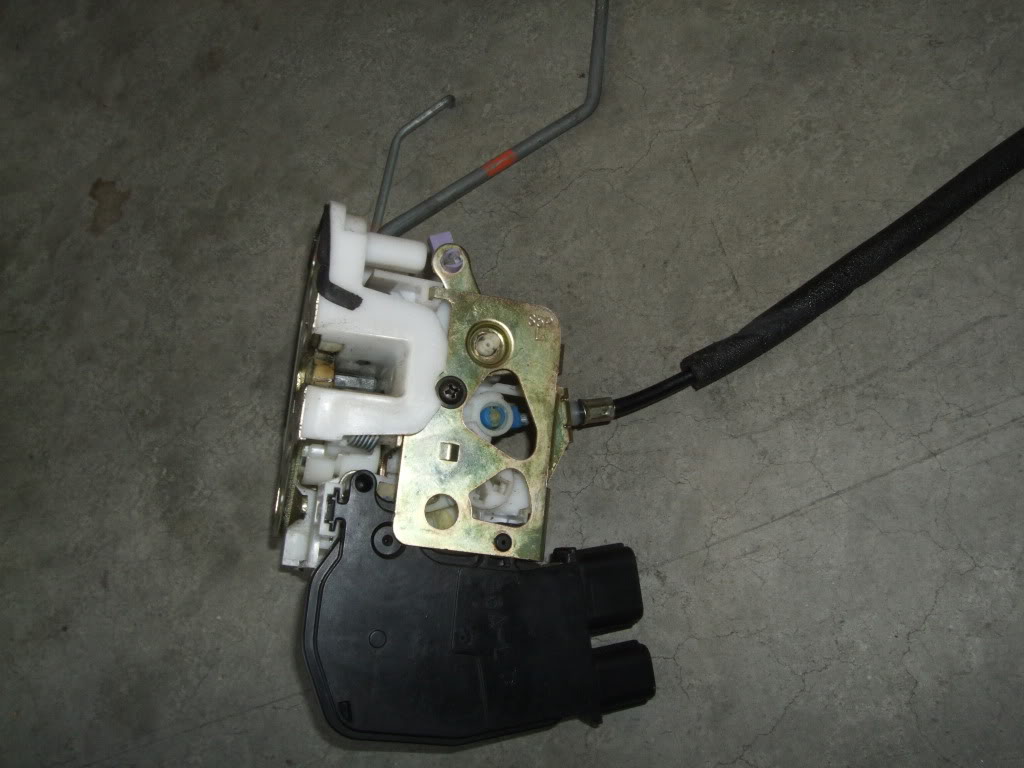

11. Removed the cable that lead to the lock button, removed the black screw and the metal plate to get to the black motor

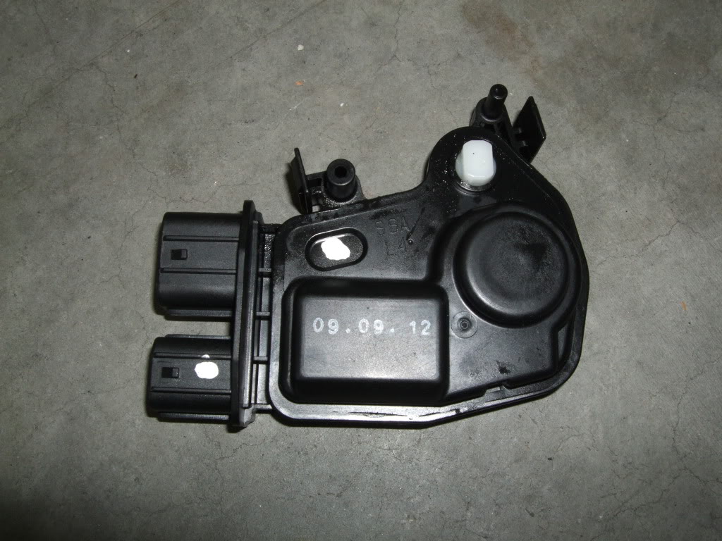

12. Replacement actuator motor
13. Reassembly with new motor in
14. Reassemble everything the opposite way you took it out
The only thing different is that i replaced my motor while original DYI replaced whole assembly

Broken wires in the door harness is a common problem with the 7th gens, if you're like me and you want it fixed cheap and immediately you can remove the door harness and repair it, I spliced in an extra couple inches of wire so all the bending would happen on the new wire and not on my joints or the old wire. You can also get a new harness from the dealer, it will cost like $20-$30 and you'll probably have to wait a couple days

Yeah I had a mind block (or something) about it potentially being a break in the wire harness on the drivers door.
Not sure why as I've fixed window and lock issues on rear doors due to breaks in the wiring harness.
Once it stops snowing I'll check it out.
