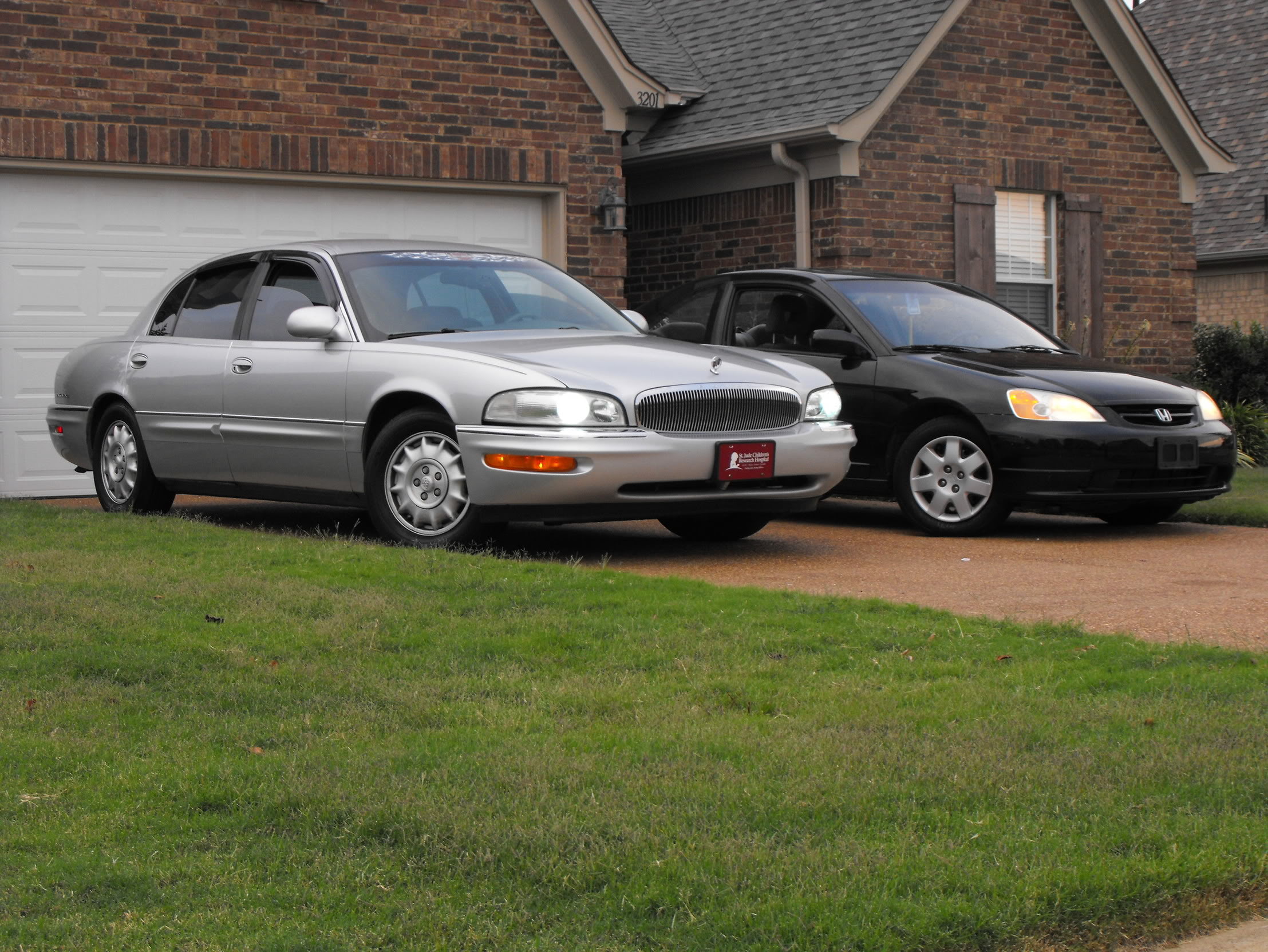

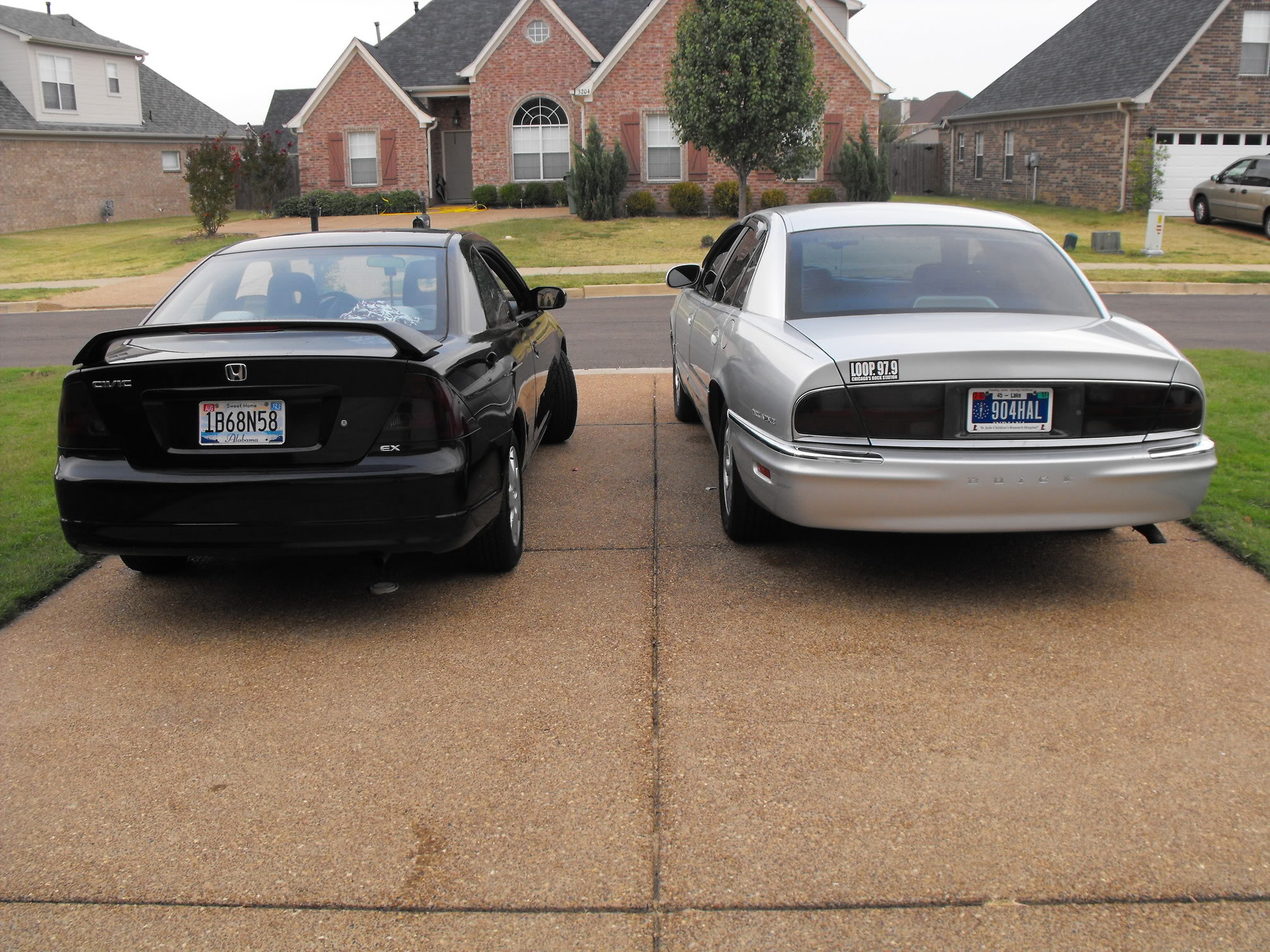

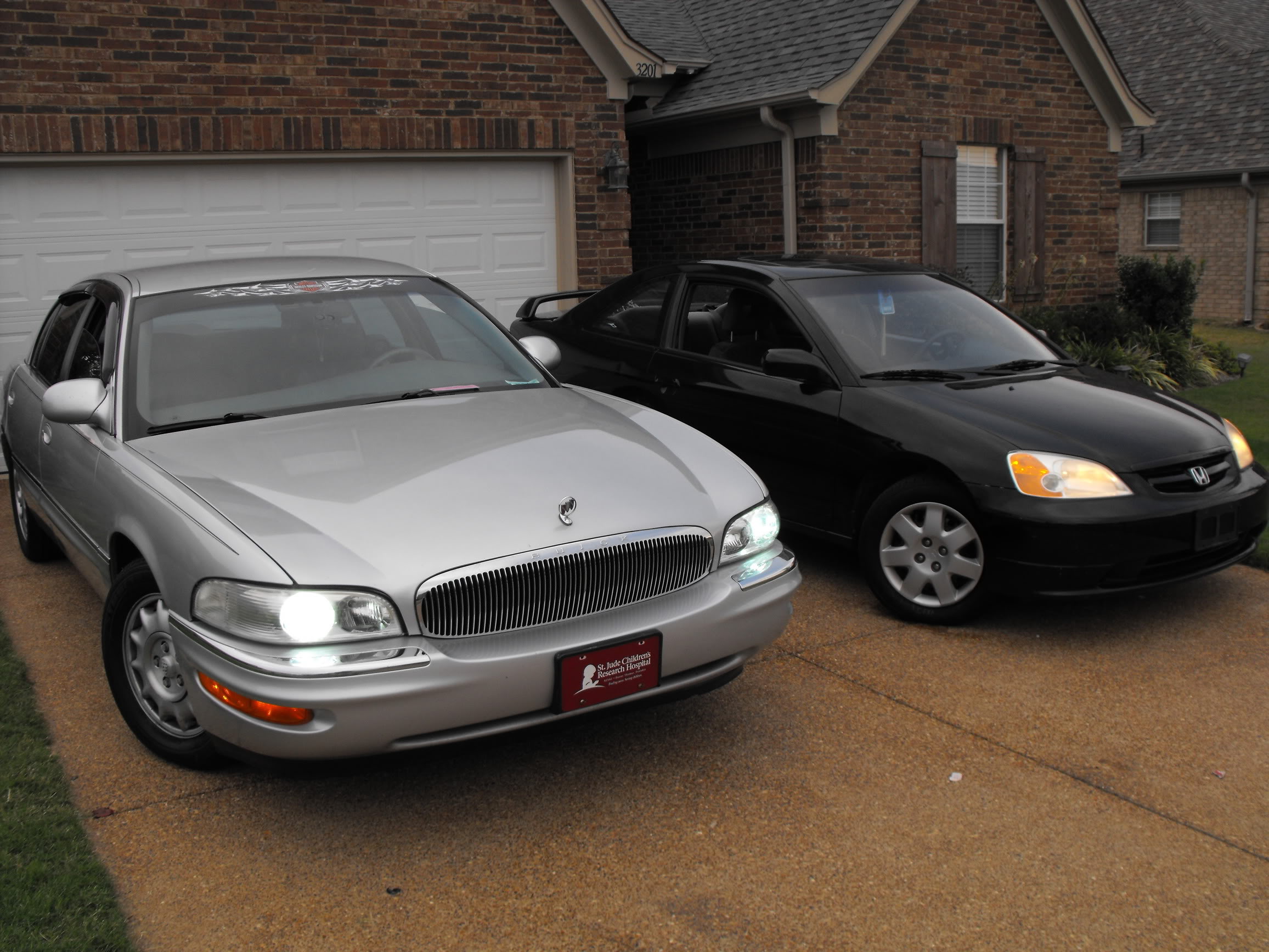

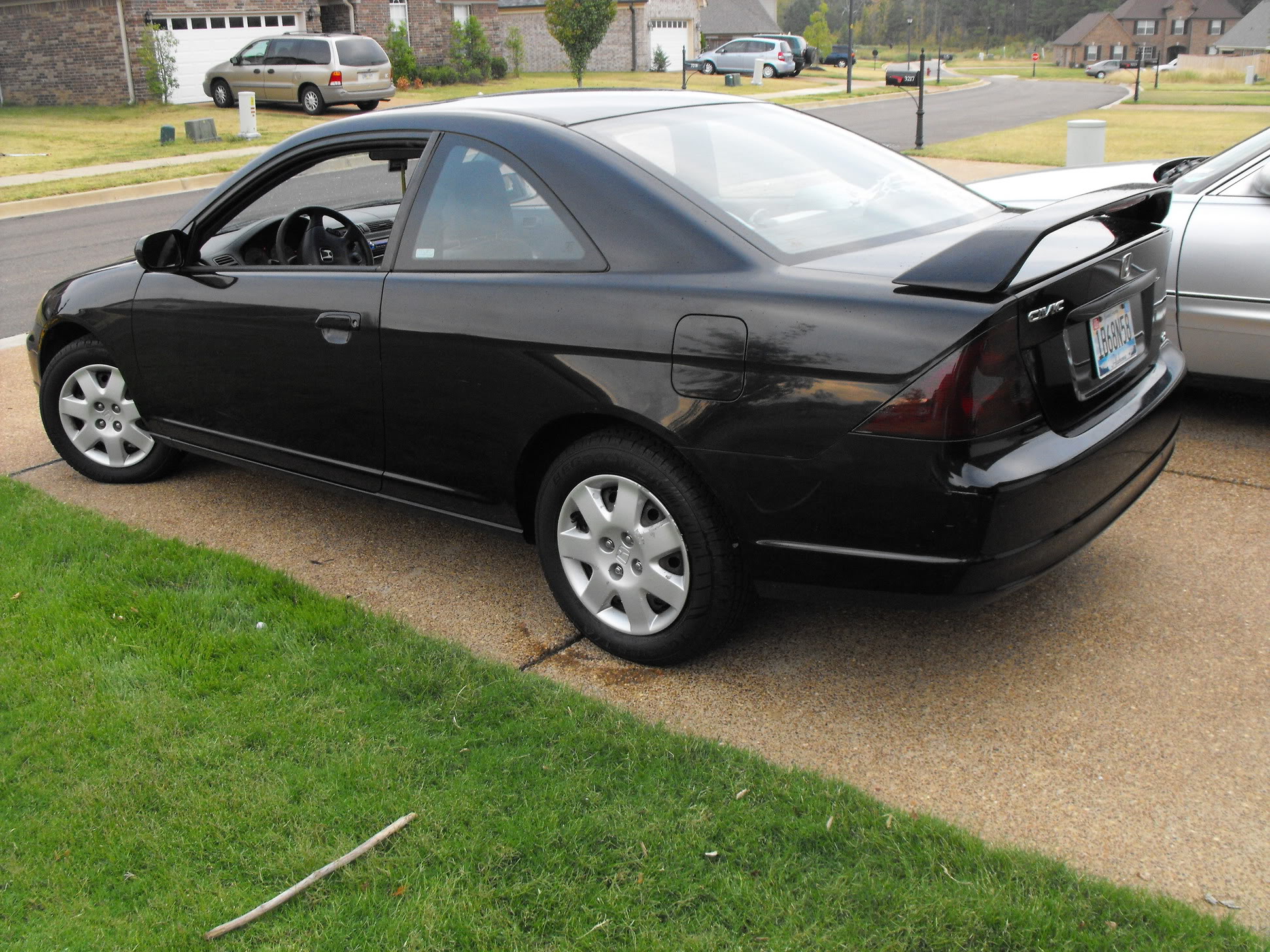

heres some pics of our cars for anyone intrested.

Those are really nice tinted tails you got. What percent is that? And have you got pulled over by any cops for being so dark?
hey, sorry for not seeing this... i thought i had email notification enabled for this forum but i guess i didnt. its just 30-35% cling on window tint from autozone.
heres a video, if you want a tutorial with more details just let me know. i made an entire tutorial post on another forum with highly detailed pics.
[YOUTUBE]http://www.youtube.com/watch?v=T1nDQ__44v0&feature=channel_video_title[/YOUTUBE]
and as for being pulled over, since you can still see them during the day from 500 feet they're legal. but on the off chance you do get hassled you can just peel it off
