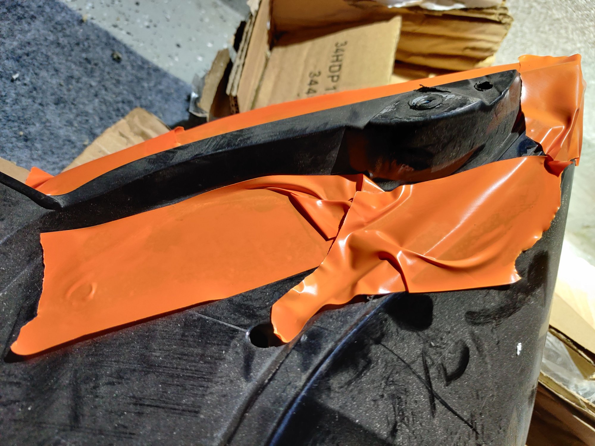

i masked the edges so if the dremel slips it doesn't mark the paint
this is the rough cut line on the inside you need to make so the spoiler will fit

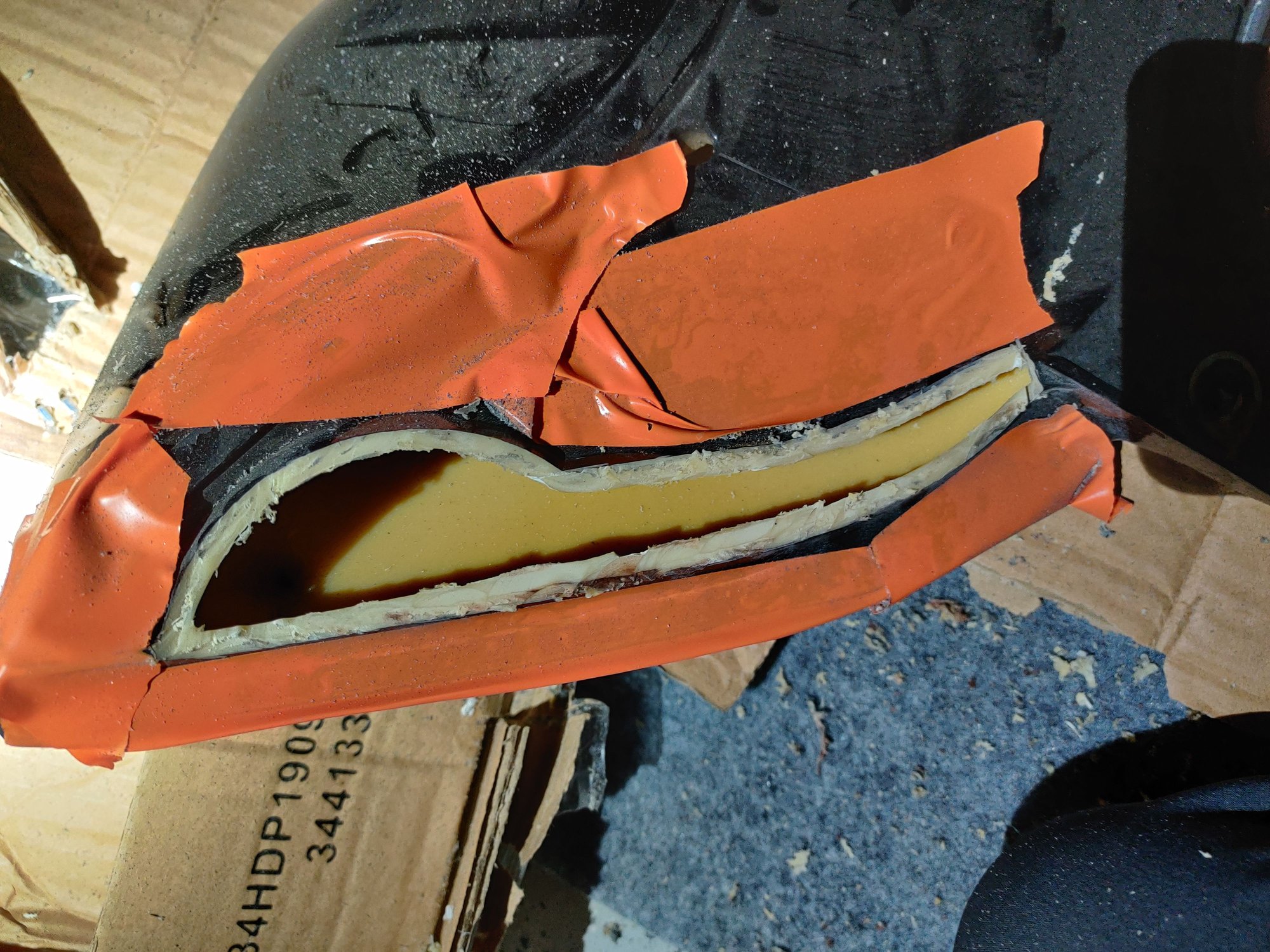

this is the rough cut line on the outside edge needed for the fitment
this when the stand offs have been cut off and its rough so it needs sanding a bit to look better

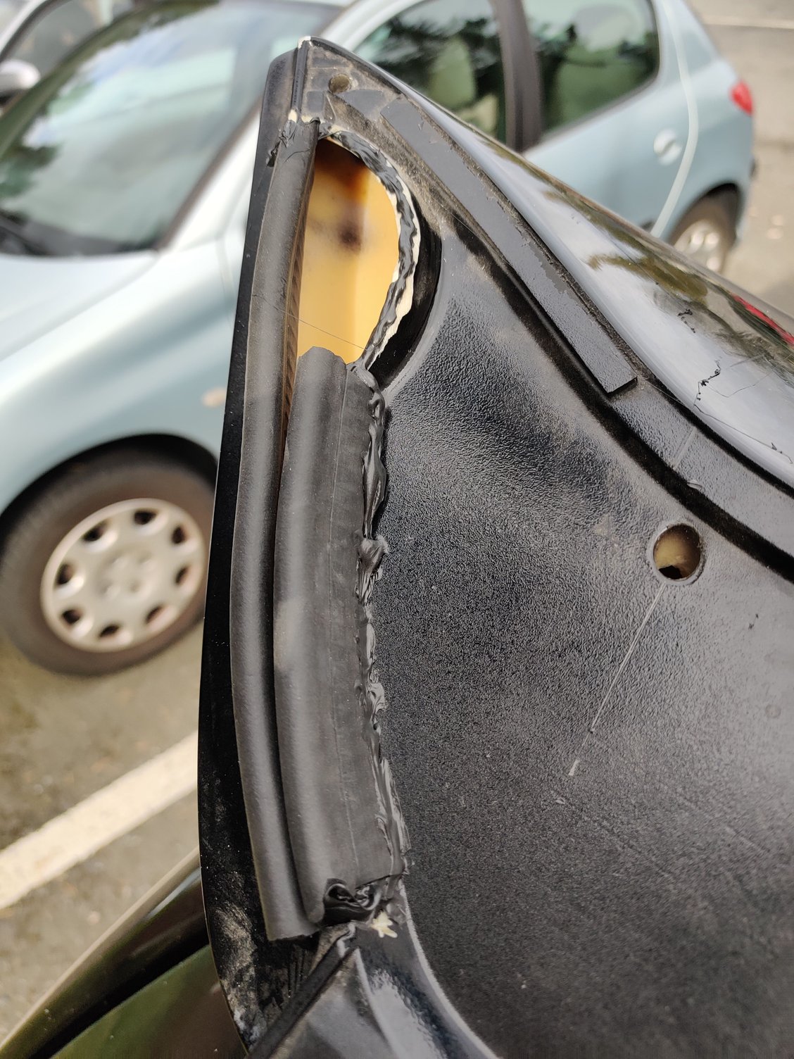

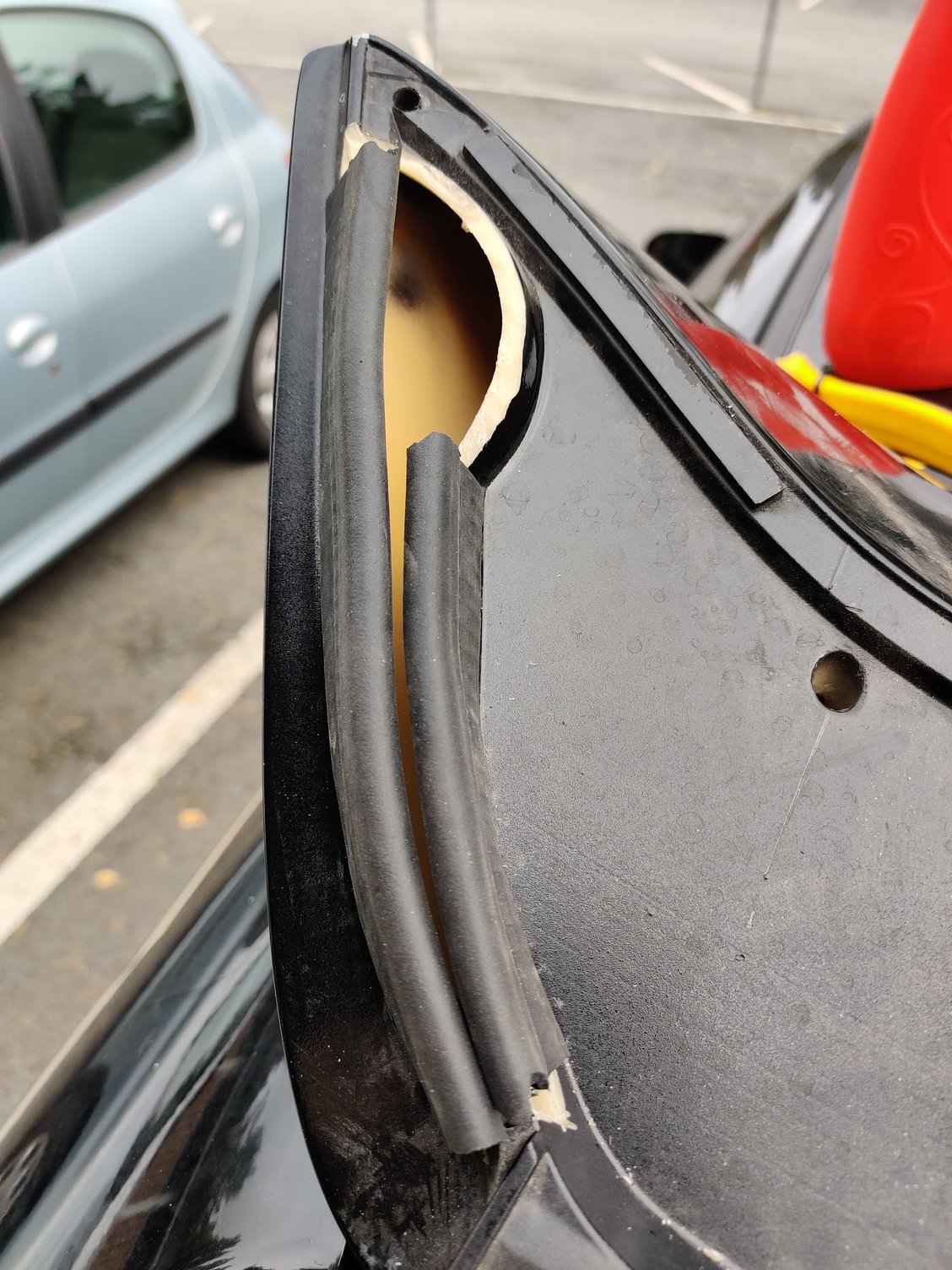

i used some straight edge rubber molding to make the spoiler rattle go away
i added some silicone sealant to the edges so the edgeseals are firmly mounted to the spoiler
the straightedge molding i used might be a little too high profile i might trim them a little bit to get more flush fit on the bottom part

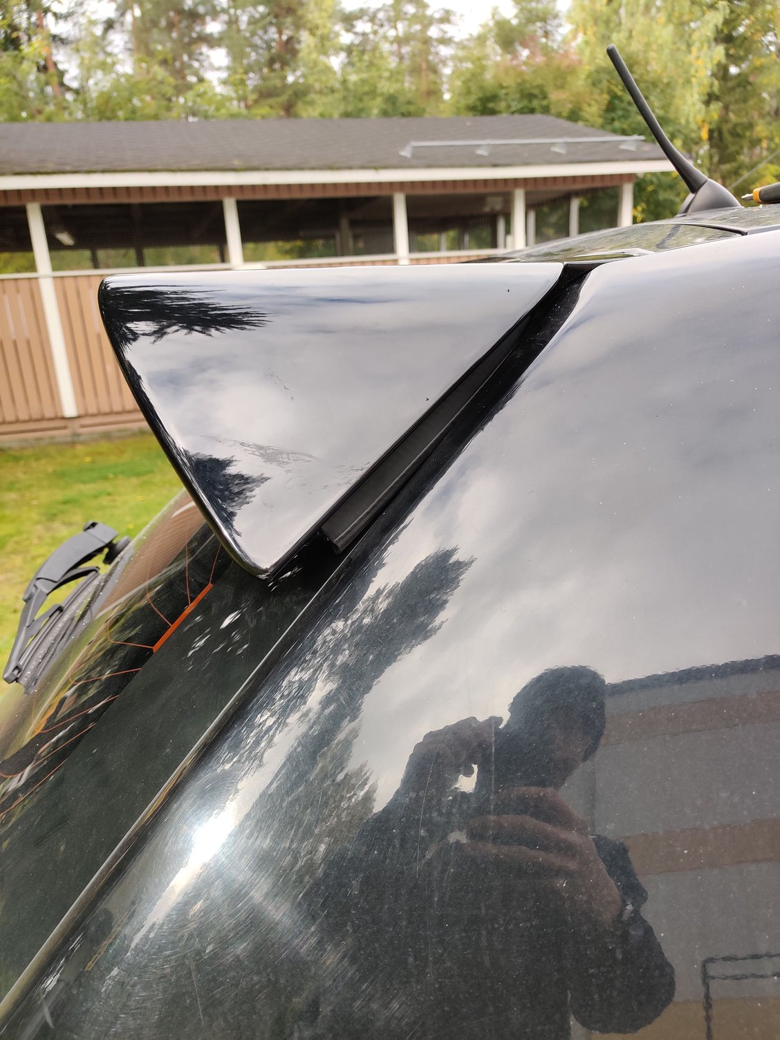

here is a comparison on the old little tiny lip vs the new type r spoiler
