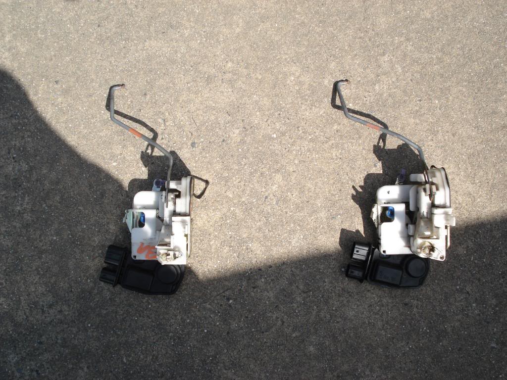

This is a DIY guide for replacing your door locking assembly. Mine crapped out on me at 60K miles, and i had to replace it. The driver side lock would not lock anymore, and i had to lock my car with my keys. The easiest way to fix this is to replace the door lock assembly. I hope this helps anybody with the same problem.
First remove your door panel. If you dont know how read this DIY:

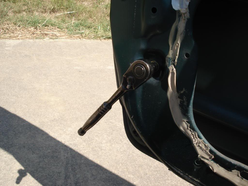

Take out this bolt:

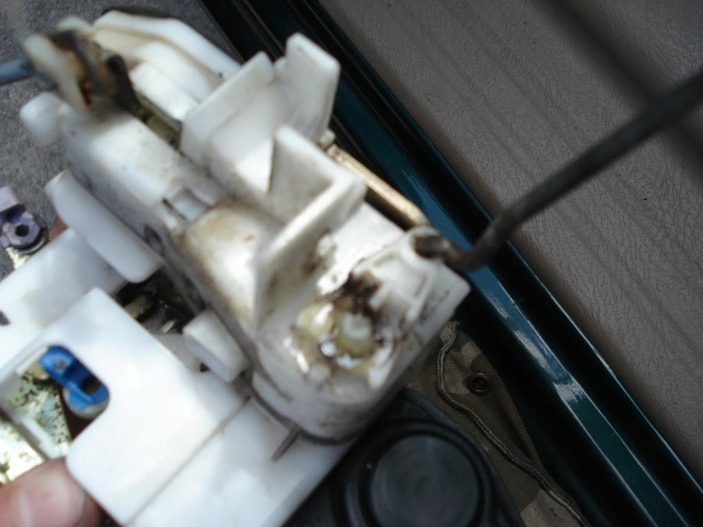

The door lock assembly can now be pulled out of the door. Once its out unclip this cable:
And take this wire out:

Then take your working lock assembly and reinstall all the wires and put it back in your car.

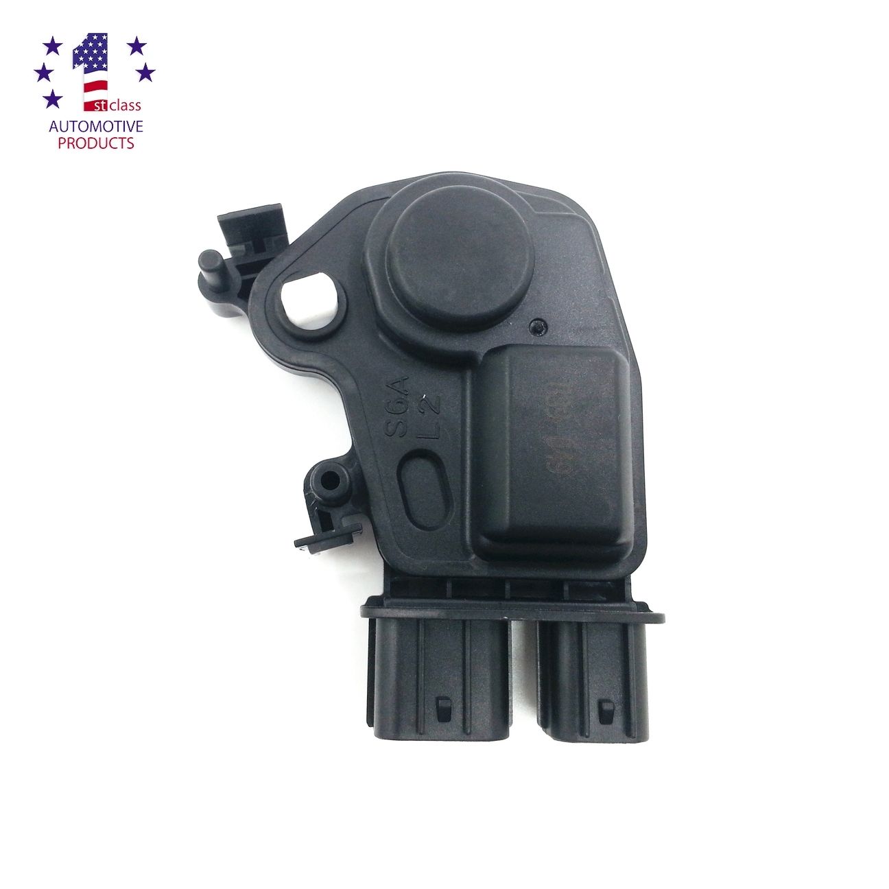

Personally I just purchased the lock actuator itself instead of the whole assembly. All the places around me including the junk yard wanted like $75+ for the whole kit and I didnt really feel like waiting to have it shipped from hondaautomativparts.com(SP?) so I just went to autozone and got the piece I needed. Its super easy, just pop a few things off and your too it. I did have some pictures but I think I lost em ...Found one, you just take that bracket off, remove the cable in the top right and If I remember right there is a pin on the backside as well.

Today I replaced my driver's side door lock actuator, oem part number 72155-S5P-A11, on my 2003 Civic LX coupe. I bought a new one from eBay for $8.20 . See photo below. I got delayed with the step pictured above, under "pop this wire out." After two hours, I could not get this wire (a rod, to be a bit more precisie) out. I finally tore out the plastic insert/clip which attaches the rod. I shopped on the net for this part and found, for once, that buying this part from my local dealer was less expensive than buying from eBay or an online dealer site, after taking into account shipping. The part number is 72181-SD4-004. Honda parts sites call it a bushing. It cost me $2.92 + tax. I doused the new bushing in foamy soap. Without taking off the door handle, I had the bushing installed with the rod clipped in within five minutes, using a pair of slip joint pliers.
Per the OEM service manual's directions, I tested the old actuator, applying 12 volts to the two-pin connection, then reversing the polarity. No click, nothing. Then I checked the new actuator: The click happened when I applied the 12 volts. The new actuator is now installed. all works fine.
The old actuator had Nov 2002 stamped on it, so I expect it was the original. Interestingly, the new actuator had the exact same identifying numbers stamped on it.

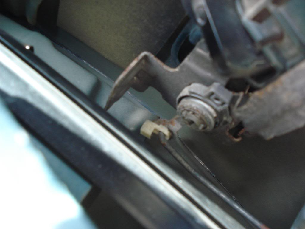

Hi all. half way through a lock actuator replacement and im stumped on 1 stop.
at the end of the inner door rod there is a metal clip. I cant seem to find where that screws on to. it is the lock end of the rod that Im confused on. I must not have paid enough attention when removing.. any advise?

pictures arent working for me, can you see the part you're talking about in one of the other pictures on the thread? what door are you working on? take off the other door panel and look at that and see if you can figure out where it goes?

That's good advise. I had to look at the part I removed to figure where the rod and retainers go. Neither end screws into anything so I must not be following well. Just pop the opposite panel and have a look.

im stuck here.... is there a clip or something holding this on? i already bent my screwwdriver trying to pry it off..lol
