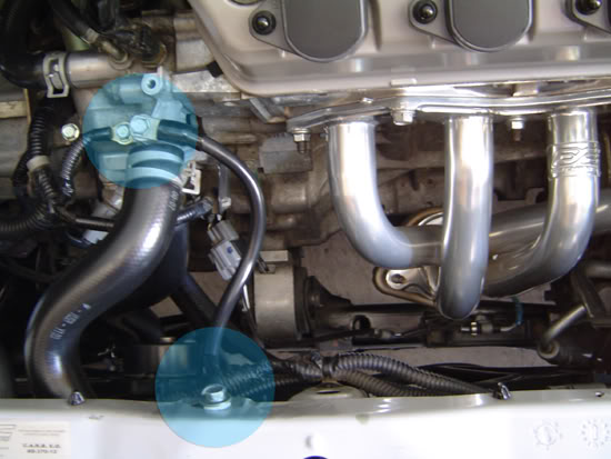

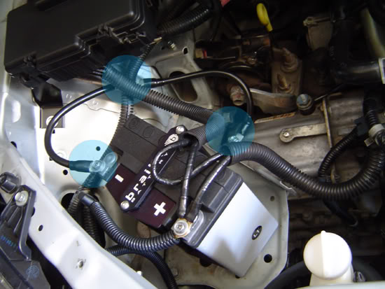

Re: DIY: Grounding kit Install
this is all you need to know. upgrade factory grounds with nice 4 gauge wire and ring terminals. i used premade versions from batteries plus. blue circles denote connection points. you need 3 cables total. negative to chassis, chassis to trans, and engine to chassis.

that's one tiny battery.
Old Aug 1, 2012
  #292
braille B2015 15 lbs battery which is more than enough for me. 425 cca i believe.
