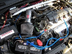

my setup
I got my setup installed a few days ago. I got all the stuff for $20 at my local sound shop.
I noticed that when I remote start my car now, it doesn't hesitate. Before it used to churn too long sometimes and it sounded kinda bad. Other than that I haven't noticed anything too noticeable, but then again I never have had any complains with my car. I love my car.
take a look and feel free to comment.

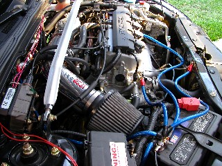

pic 2
pic 2

IMO, if you were going to diy .. i'd do something similar to sepudo:
every ground point he chose is in contact with the negative terminal
Old Aug 5, 2003
  #180
slamtank's Avatar
Posts: 754
From: Raleigh, NC
slamtank is an unknown quantity at this point
oh yeh..that looks good..
as u see there, he gathered all the wires at negative terminal..
