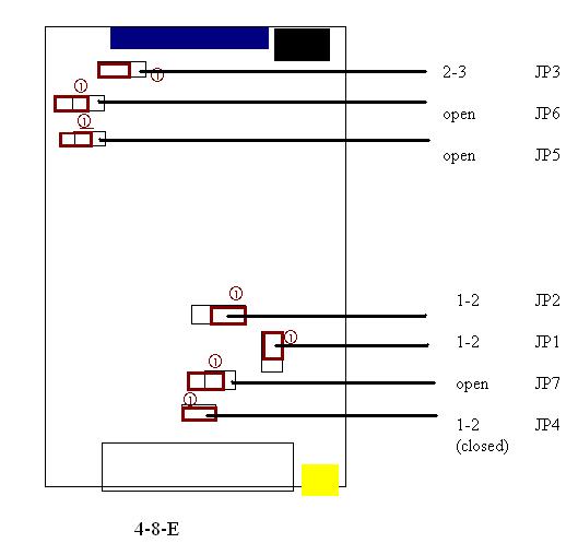

Ok guys I've been at this numerous times and have done a lot of research. I have the exact same settings as dezod and he said it works perfect. I check jumpers and switches at least 5 times now, and have rewired it already.
After an ECU reset, I make sure the emanage is set properly with my support tool. Everything is reading ok, sensors working, tach working etc...
Start the car, perfect idle. No CEL. Within 2-3 min of idling it becomes really rough, almost dies then revs to about 3k. CEL comes on but shuts off after I kill the engine, and the code the emanage reads is 14 (VTEC Signal Input Error - JP4).
I uploaded a diagram I made on paint on my EXACT settings. Please chime in on any updates, I daily drive this thing and am running out of wire to cut. Thanks.

Joe I had a similar problem. I'll pull open the E-manage and tell you my jumpers in a bit. Busy right now.

1. Check the firmware verson - Version 1.39 is the latest.
2. Check the value of the various sensors with the logging feature and see what they do.
3. Not that its a big deal, but your A.A.V. setting at point RPM point 2000 is not zeroed....best to zero it.
4. You stated it was a vtec error. What are the settings for the vtec in the emanage? If the deadband is set wrong, it will give you an error!
5. What is your wiring (ie where does it go) connected to?

I already updated the software, and the firmware. I confirmed it being v1.39 (the update was meant for karmon type sensors i think)...
The VTEC settings are as follows...
4200 LO-HI
4000 HI-LO
No air/fuel corrections with VTEC.
As of right now I am only using the main harness. I figure I'd start with that and work my way into the more complex stuff. It's running through the center console, with the leads soldered about 4" from the ecu.

"JP4 airflow/VTEC input select
1-2 VTEC
2-3 2nd airflow meter
* Even if you don't have a 2nd airflow meter, leave it on 2-3 for non-
VTEC applications
* On 1-2, enables pulldown resistor (for use as VTM signal). This is
required because the VTM output is inverted with the VTEC out."
-Quoted from dezod's write up.
What concerns me is that my JP4 setup is either 1-2 (shorted) or just leaving it open. I don't have the option to set it to 2-3. Anyone care to explain this?

Talking OFFICIAL WORKING 01-04 EX wiring and settings!!!:
Ok guys, because Greddy has no idea how to translate things into English or write a working manual, many of us have had problems. Optoisolator and boosted2k2 have both got it to work great, BUT they have LX's. This is good and all, but they are wired completely different (except for the TPS, power, and ground). The jumpers are also VERY different.
Here's what you want to wire:
Emanage:-------------ECU:
Red ---- +12VDC-----Yelow w/Black stripe (pinout 2, connector A)
Black ---- GND--------Black (pinout 4, connector A)
Brown----RPM--------Blue (pinout 7 on connector A)
*Grey------TPS---------Red w/Black stripe (pinout 15 on connector A)
White---Map Input--Green w/red stripe (pin 19, conn A, away from ECU)
Green---Map Out----Green w/red stripe (pin 19, conn A, TO ECU)
**Yellow--VTEC IN-----Green w/yellow stripe (pin 15, conn B, TO ECU)
**Lt. Blue-VTEC OUT--Green w/yellow stripe (pin 15, conn B, AWAY from ECU
Purple---VTM Out----Blue w/black stripe (Pin 9, Conn B, TO ECU, cut and terminate signal from engine, the purple wire is to be soldered directly to the blue/blk wire going into the ECU. Tape off the cut part of the wire that is no longer connected to the ECU.
* - Greddy left the gray wire out of the wiring instructions. This is your throttle position signal.
** - THIS IS WHY MY CAR WAS MESSED UP. Greddy wrote the directions BACKWARDS for VTEC cars. Reverse what they say and you'll be golden.
Ok, after wiring in the harness, you need to set your Emanage switches and jumpers. You could have done this before the wiring, but it really doesn't matter yet.
Jumper settings:
JP1: 1-2
JP2: 1-2
JP3: 2-3
JP4: 1-2
JP5: see writeup...
JP6: (1-2) but because I didn't select them on the maps, it throws no codes
JP7: OPEN
---For jumpers 5 and 6, this is for sub injector controlling. I have mine enabled (1-2) but because I chose not to select the maps in the support tool software, it isn't doing anything differently. I did this because if I do use it as an injector controller, I don't have to open it back up again later to mess with the jumpers.
ROTARY Switches:
This has been debated/discussed for quite some time. 4-8-C works great on DX's and LXs, but within 2 hits of VTEC you have a CEL and an engine in limp mode. 4-8-E works VERY well. No codes, smooth idle, VTEC adjustment. This is the switch settings that you WANT for any 01-04 EX civic. It has been tried on my 5-speed boosted EX, and Dezod's currently NA Auto EX. So there's no debate that this setting won't work with an EX. It works flawlessly.
Suggestions: Buy an OBDII scanner (you can find them at autozone). It will come in handy and help you trouble shoot any problems you may have. Solder all of your connections. Don't take shortcuts but crimping unless it's only a temp thing. Soldering is the way to go, why risk it? I mounted my emanage in my center console behind the shifter. Very easy access and the wire lenghts are absolutely perfect.
That about sums it up. MAD PROPS TO DEZOD. He's the guy who went through all this hassle for 2 days on his own car to figure this out, and looked up quite a bit.

thanks for the heads up. I hope everything works out. But wouldn't the VTEC not engauging be like having a VTEC eliminating cam? i thought not having vtec is better for boost?(guess not sincce you can't spin first)

It's better if you have a cam meant for not having VTEC. But when the 1st cam is a grind for lower rpms, you still need something for the top end.
I messed with thtis thing all morning, with diff rotary settings, software settings, and whatnot... Nothing but problems. 4-8-E is no VTEC but the engine runs incredibly well at low-mid rpms. I'll be resetting the emanage and wiring it to only control fuel and timing. I liked where my stock VTEC was and didn't have intentions on changing it anyway. I'll post up more updates again.

oh so the only reason that the vtec was having problem is because you were using the vtec engaugment controller?
