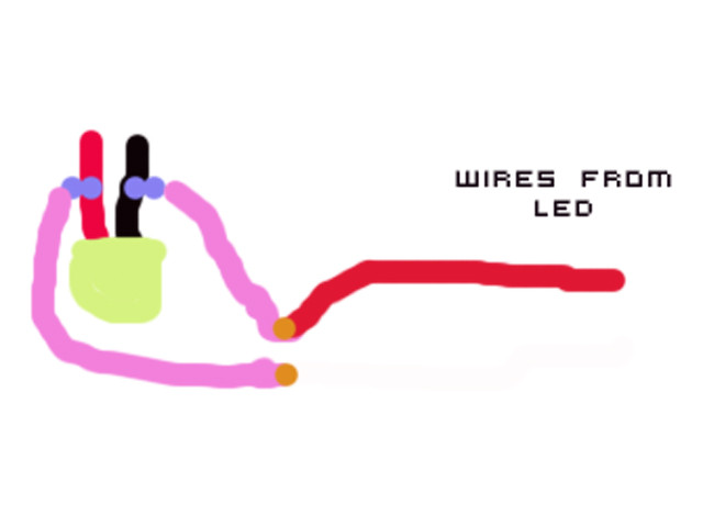

Yea.. Let us know what the multimeter tells you.. Only way to know for sure. You're using 14-16ga wire taps? I think you need the 18-22ga ones..

Heres a quick diagram of my setup.
Blue is the tap connector.
Orange are quick connect(spin cap thingy)

Re: What HID bulb type do I need?
lol.. MS paint ghetto-fabulousness
You've tried both red-red/white-black and red-black/white-red?
yeah
Interesting.. definitely take a multimeter to it.. I'm out of ideas.. Unless you LEDs magically **** themselves..
but i tested them with batterys after. lol. yup borrowing a multimeter in the morning. ill report back, if there is no current then that means the tap thing isnt doing a good job cause the parking light is working so current is getting through from that wire, its the 16guage that might be causing problems. ill report in the morning if you are all out of ideas
it was that the wires werent tapped, i was right. and i proceeded with the install and guess what, one of the bulbs dont work. now i have a car that is undriveable, im screwed for like 2 weeks till i get replacements
