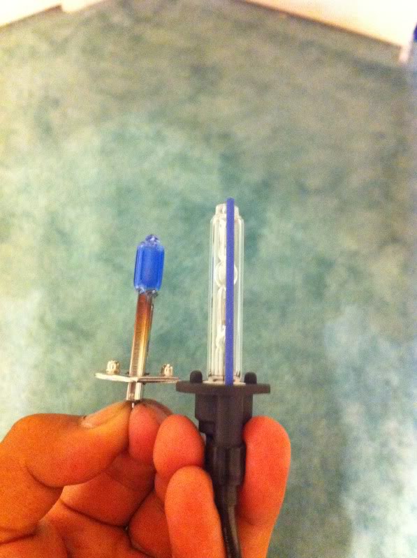

Old Jul 9, 2010
Rep Power: 513
Re: What HID bulb type do I need?
the hole the bulb physically goes into. The HID bulb is a little bit fatter than a halogen H1 bulb, and some bulbs have a ceramic base on the bulb adds about 2-4 mm to the overall diameter that needs to fit in the projector.
Just looked at a set of DDM H1 bulbs I have and the ceramic base is recessed into the plastic base.
comparing the 2 bulbs, it looks like it should fit, but putting the bulb into the projector housing is a completely different story. If/when you get your HID kit/projectors and wanna put 'em in, expect to make a day project of it, it'd prolly make it a bit easier to pull the headlights apart and remove the projector to modify the housings. Just take the bulb, see how well it fits into the projector and modify as necessary.. You just gotta kinda play around with it for a while for it to fit right..
