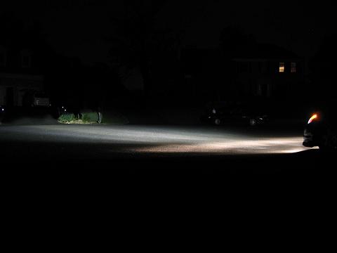

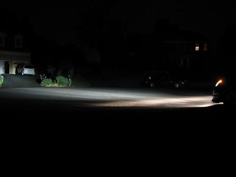

gonna add mine
e46 bixenon projectors
philips d2s 4100k
day time pics of projectors
color at the cutoff

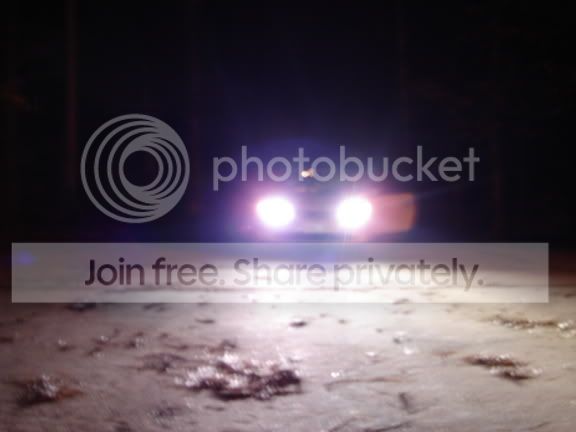

btw: I know there is MAD glare...and can someone please help me find some info on where to get some caspers so I can have a nice cut off line......

Do you think my problem is because of the lack of a glare shield or bad aiming?
Old Apr 27, 2005
  #222
ASIANPRIDE's Avatar
GODLIKE
Joined: Apr 2001
Posts: 2,449
From: Chinatown, Alberta, Canada
ASIANPRIDE is an unknown quantity at this point
Exclamation
I called Caspers Electronics and asked about my Prolumen Rebased H4 bulbs and he said that the shields that they sell will only work for D2S or the D2R HID bulbs and not rebased ones. Sooo looks like the Prolumen kits don't come with shields and tricky aiming will be the only thing one can do to reduce the amount of glare that I'm seeing.....
So the only other option I have is fiding bulbs that will attach to the harness I have and that they have shields built onto the bulb....or I could spend the $65 US and attempt to modify the caspers to fit my h4's with the risk of messing it all up because I would have to remove the current base and find a way to attach the bulb to the Casper base with some sort of glue....so the positioning and aim of the bulbs could be completly off.....
So it looks like Im just going to spend some time aiming the headlamp down as far as it goes....

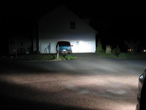

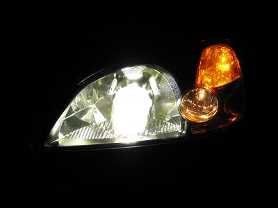

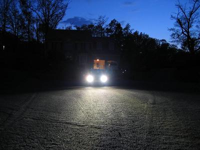

wuddup hoes. new retrofit. it already sucks

The yellow isn't obvious is any of the pics except for the the one of the close up shot of the headlight. Have you figured out whast wrong?
Old Apr 27, 2005
  #232
dirtySAMURAI's Avatar
I log in from time to time
Posts: 15,682
From: VA
Rep Power: 435
i have no idea. i'll fix it later though. and the tilted headlight...that one will get fixed later lol

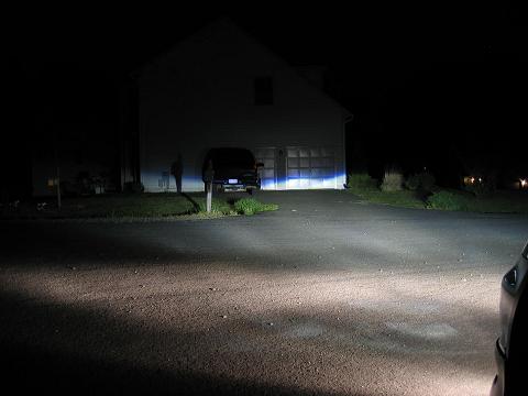

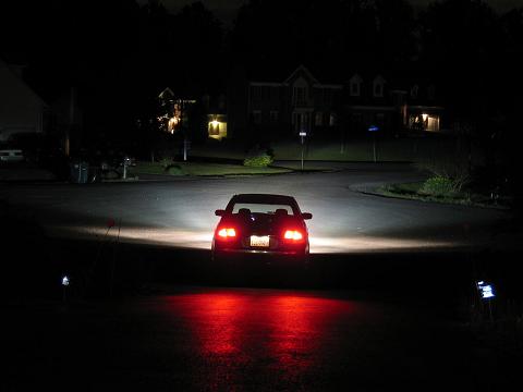

here's some new pics bi-xenon pwns me

i see that you finally have high beams. Was it hard to install the highbeams? With my e46 i had to get a bi-xenon control circuit and then solder a diode. Man your zkw seem like it got a lot of color at the cuttoff. Very nice.
Old May 5, 2005
  #239
Posts: 15,682
From: VA
Rep Power: 435
it wasn't as hard to get bi-xenons as it was to get the tyc to work properly. and yes, they have a LOT of color at the cutoff. it's orgasmic
