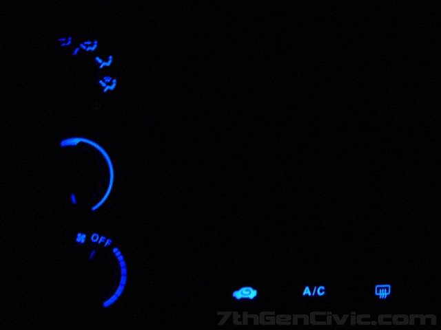

hey can anyone do this for me?
if I were to pay someone..could u do this exact thing with the lights for me in green?
pm me
thanks jon

The needles do light up, but only half as bright. The pic doesn't show it since my digicam sucks, but trust me they do light up, just about half as bright.

why dont his needles light up??
i am gonna do the condoms, just cause my dome lights have condems on them too. so then they will all match. imp:
