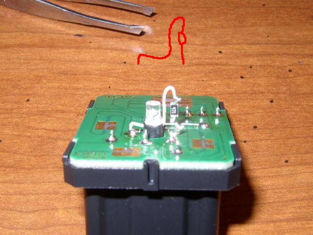

I dont mean to offend any of you guys. but your installs for thermostat and cruise, mirror, sunroof lights are a bit messy. I've done a DIY which is posted on www.99accord.com for the thermostat, and am currently working on the cruise, mirror, sunroof. Mine is a lot tougher to do, but it's so much cleaner, and no extra wires to worry about. Check it out, also, here is how i did the mirror. Resistor on the right. just bent the wire in a funny shape.

Wow, nice. Mine is rediculously messy. There are wires all over and even between the switches. The moonroof was really bad, since that's the only way to do it with 3 LEDs. The light won't be even if you just replace the stock bulbs with LEDs, unless they're super bright (but they still won't spread out like regular light). One of the hardest things I've done.

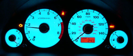

i just blacked out my stock needles

Hey that looks good! Better than the red/orange with the indiglos. Much cleaner. Did you just use electrical tape?

no just 4-5 coats of white and 1 good coat of black. paint pen
