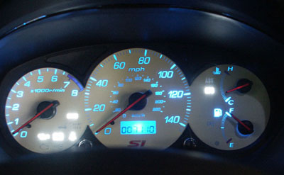

Here's the one you were talking about with white light. Looks okay. Maybe you should just follow his diy I guess they have replacement LEDs that fit in the stock bulb holders. You could technically buy 5 LEDs from autolumination and swap them in. Don't know how bright they would be. I would advise on getting the opaque ones, otherwise you're just gonna see bright spots where the LEDs are.

Here is mine with just the needles turned on. The halo lights up all the numbers, but it's still dim. I hope those blue bulbs work out.

the pic u took looks like the guages are very dim... but that could be the camera?
Yea, those guages are hot... u can see where the red hit the blue though (purple) kinda looks cool though like that (fadin)

Yeah, the pic I took was with just the needles on and no backlighting. I'm still waiting on the blue bulbs cause it's too dim.
