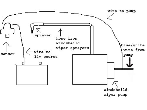

is there a DIY somewhere for the alcohol injection? I know nothing about hooking that up.

while i'm not sure exactly where to put the sprayer and sensor, maybe someone can help you (and me, lol) out with that, but from reading the DIY it should look something like this. on the sensor there is a "ON" and "C" screw, the wire from your 12v source (doesnt have to be the battery, i used it as an example) goes to the "ON" screw and the wire coming from the pump connects to the "C" screw.
isnt the alcohol injection adjustable as well? so it will turn on at a certain PSI? i thought i read that somewhere....how can you adjust it?

the alcohol injection is adjustable. You have to use a pressure regulator and a test light or a multi meter to test it though. But, the adjuster screw is in the back of the pressure sensor, its covered up by a small rubber plug. just pull the plug out and there is an allan head in there.
