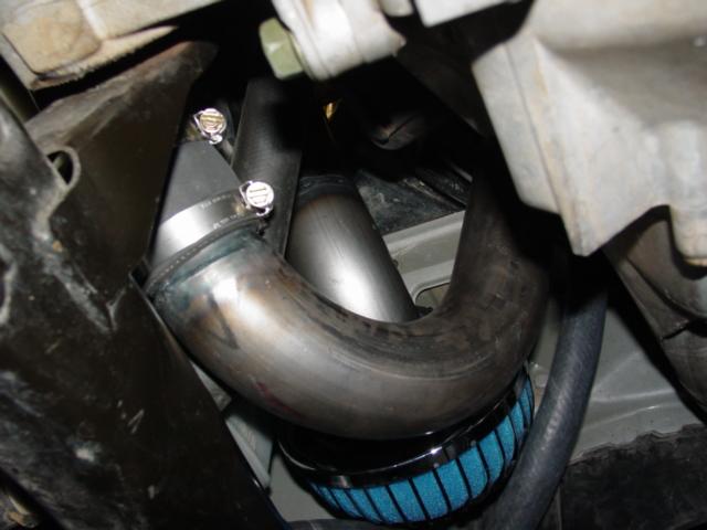

intake pipe

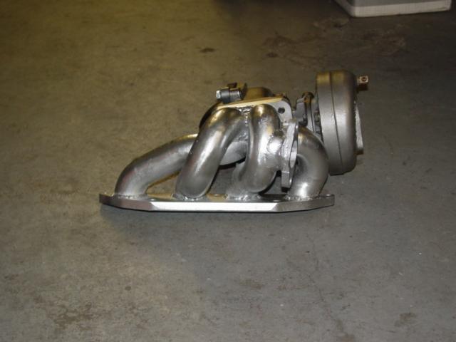

equal length header
Name:	equal length a.jpg

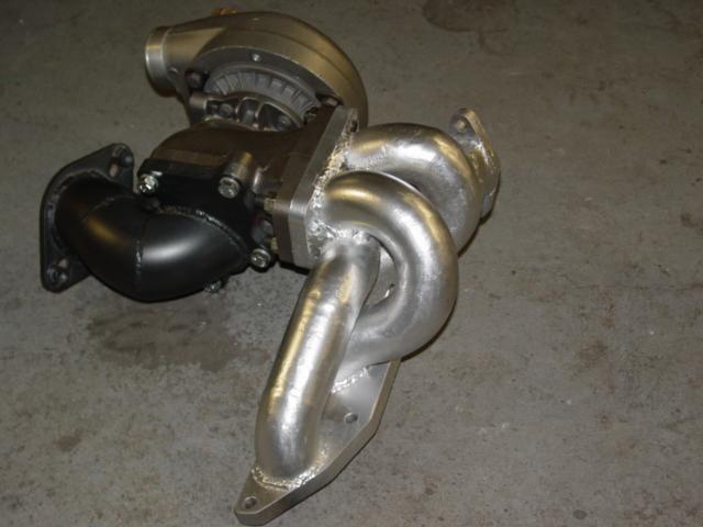

equal length 2
Name:	equal length 2 a.jpg

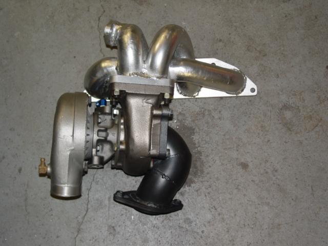

equal length 3
Name:	equal length 3 a.jpg

i don't know all that much about turbos, so bare with me if these are stupid questions: what is an equal length header? what is so great about it over the other header? does the equal length header come with the base kit now? and what is that bung/opening/fitting on the top of the 2nd pipe for?
Old Jul 20, 2003
  #97
Catalyst's Avatar
Posts: 3,071
From: Lancaster, California, US
Rep Power: 313
Catalyst is just really niceCatalyst is just really niceCatalyst is just really niceCatalyst is just really nice
The equal length header improves cylinder scavanging. So you will make more power, and the turbo will spool up faster. The flange on that runner is for an external wastegate. The external wastegate option doesnt cost any extra.
The equal length manifold is $100 more.

ok, i see. so what are the advantages and disadvantages of an internal and an external wastegate if i had the base kit with the equal length header and the turbo upgrade (ar.60 int)? the base kit does come with an internal wastegate, right? oh, and am i able to purchase the base kit with just those two upgrades without having to purchase the water-air intercooler and 3" downpipe (by the way i have a 2002 ex, if that makes a difference)?

The air-water kit is an upgrade just like those. so you can get any combo of parts you want.
The external wastegates are easier to adjust and prevent boost creep (which i havnt really experianced with this kit/internal wastegate)
You dont have to do anything to make the kit fit an ex, we made the downpipe to fit the EX also.
The kit comes with a bleed valve, which allows you to adjust the boost setting. With the valve closed, it will make 5 psi. You just open it slowly to set the boost setting.

just need some clarification here: so if i go for the external wastegate option, sf will disengage the internal wastegate and add all the external wastegate parts for free?
Old Jul 22, 2003
  #104
Catalyst's Avatar
Posts: 3,071
Rep Power: 313
he will weld a flange onto the header for an external wastegate and take off the internal one. You still have to buy an external wastegate.
