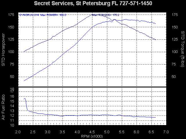

Sorry for the wait everyone I've been on vacation. These are the new dyno numbers.
My car is now running 4 rc 440 injectors in place of stock, Apexi AFC, and no additional injectors.

how many PSI for thoose numbers?

car is still at 7psi. I'm just going to wait until internals to crank it up

I am just glad to see that the AFR is down to 12:1 where it needs to be. That first dyno pull was way lean until 6000 RPM and that would of definetley lead to engine failure. So now what is your total investment in this kit?

Damn 165.5 HP and 175.2 TQ. This car is starting to look like a domestic powerhouse. BTW those are some sweet numbers. Good luck with your kit.

Very good numbers. I'm happy about the A/F too now that I know that the 4 injectors work and I don't have to add fuel into the TB.

now is that on an auto trans.... or a manual 5 spd trans??

5 spd trans
