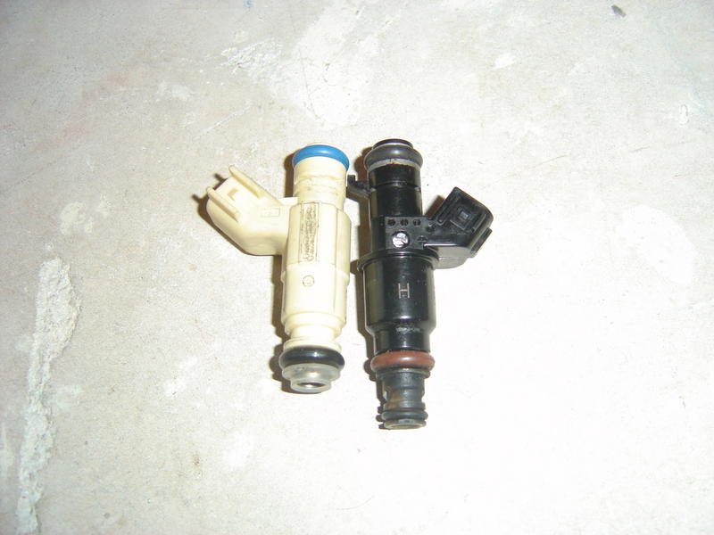

i didnt take any pics when i was doing it.. im running stock ones right now... heres a pic of rsx-s and deatsch werks next to each other... rsx is in black... come to think of it is there a sticker on the fuel rail from another brand other than honda???

Those are the exact same as the SRT-4 bodies which I'm running. There is no reason they would not fit aside from not being seating properly in either the rail, the injector plate, or both.

the rail sits a little higher with the rsx-s injector's than the stock injectors. I had to just get longer bolts for the fuel rail
