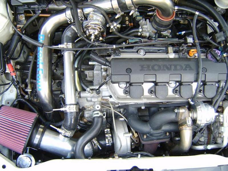

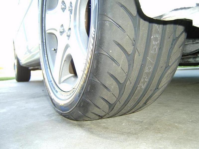

Re: Built engine is done and ready to Dyno!
yup here ya go
Hankook R-S2's in 225/50/15
I took no pics of the building process because I diddnt feel like getting my camera all greasy. There will be a video of the dyno run and maybe a short one in the car too after the tune.
What does dumping back into the intake do again?
Old Sep 1, 2007
dopes6070's Avatar
iTrader: (25)
Posts: 1,834
From: Orange County, CA (714)
Rep Power: 301
dopes6070 has a reputation beyond reputedopes6070 has a reputation beyond reputedopes6070 has a reputation beyond reputedopes6070 has a reputation beyond reputedopes6070 has a reputation beyond reputedopes6070 has a reputation beyond reputedopes6070 has a reputation beyond reputedopes6070 has a reputation beyond reputedopes6070 has a reputation beyond reputedopes6070 has a reputation beyond reputedopes6070 has a reputation beyond repute
pretty much only quiets the bov down, thats it for this car.
The BOV is a greddy RS which replaced the stock Tial one. The intake and recirculation tubes are custom.
this is a D17A1? i dont see a vtec solenoid or more obviously no vtec cover. im curious to see the torque numbers on this. looks good excited for the numbers man
its a D17A1 w/ manual trans. Im keeping the returnless fuel system but I bought 2 extra stock fuel pumps w/ cages on ebay for like $30 each to see if I could mod the stock fpr for boost refrencing or maybe replace it with a different reg that can increase fuel pressure w/ boost.
well one thing is funny, I know I need some good front brake pads now. I cant even make the car skid nomatter how hard I hit the brakes with the stock pads.
Man I love these tires!
The way you did your fuel system is going to give you lean cuts when your low on fuel FYI....
this would have been better:
