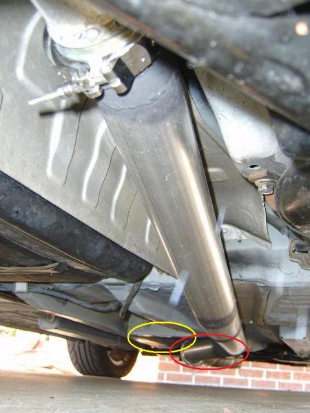

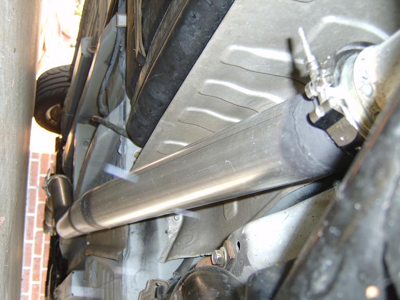

Re: Getting Ready for the 3rd tune

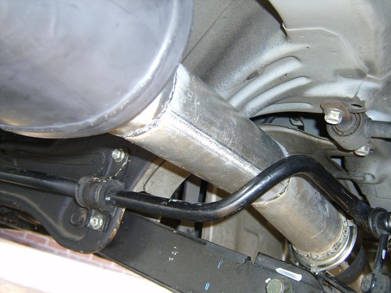

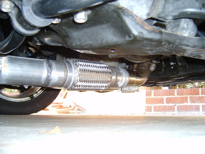

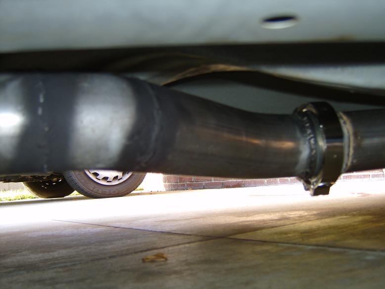

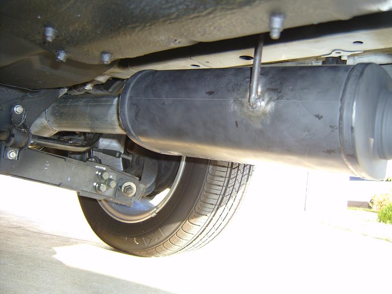

Ok here are some pics. I still have to mess with the angle of the center pipe since it hangs a bit low. And I need the put the part of the v-band where the bolt is to the top instead of the bottom. Ill have a drive by vid as soon as I can turn the boost down a bit. I will say that its definatly not as loud as like an N1 muffler but its still more then I want.

Yikes, you're right that hangs low!! I don't think there is any way I'm going to be able to keep it tucked up enough to clear these crappy roads over here if I stick with round pipe after the cat. Looks like that Dr. Gas oval tubing is going to have to be it for me. Man though! 3" piping looks sweet!!! Good job!
What do you think about making the curve further down the chassis so you don't have that crappy frame crossover to do? Kind like this (in yellow)

Well you would still have to figure out how to get past that center reinforcement (circled in yellow) which is even lower then following the stock exhaust path. I also dont like the idea of an exhaust pipe being that close the the fuel tank w/o a heat shield. I will be able to rotate the section circled in red to tuck it up more. I will probably end up welding another hanger in somwhere also since this is way heavier then the stock exhaust.

****. I didn't think about that crossmember. I'll look at it tonight to see what can be done, but it looks like you're right. I don't feel like adding a heatshield to the gas tank either. I'll get under there again tonight to see what I can do.

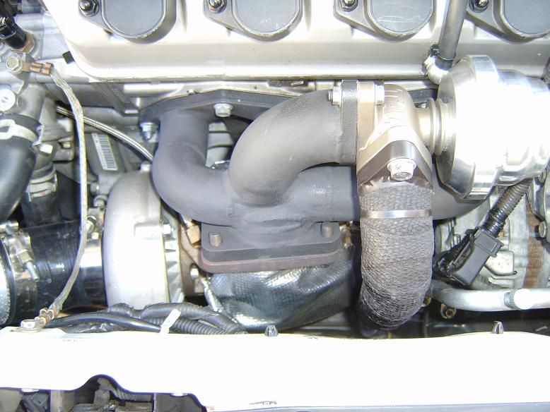

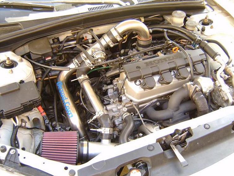

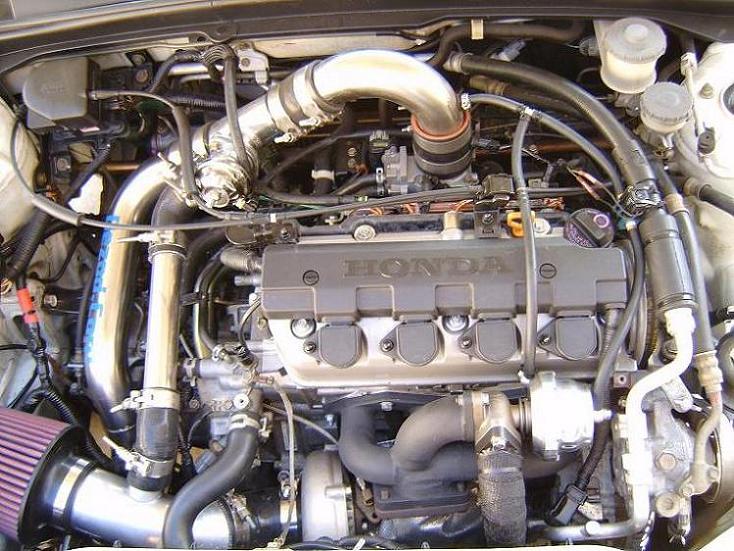

I figured I should probably put some new engine bay pics up.

why not cut the cross member and weld in a half moon to clearance the pipe? If its done right it wont reduce the strucually integrity of the member much

That's what I'm thinking about. My only concern is the fuel tank and fuel line right there. I really don't feel like dropping the tank to get in there with a MIG stinger to fix it up. I'm going to put the car up on a lift Tuesday night to get a proper look at what kind of space is involved. A decent sized sheet of allie will work as a shield for the fuel tank and you can also wrap that portion of the pipe for extra security.

dam man, looks good...i like how u ran the piping...bay looks very nice also...nice work!!
