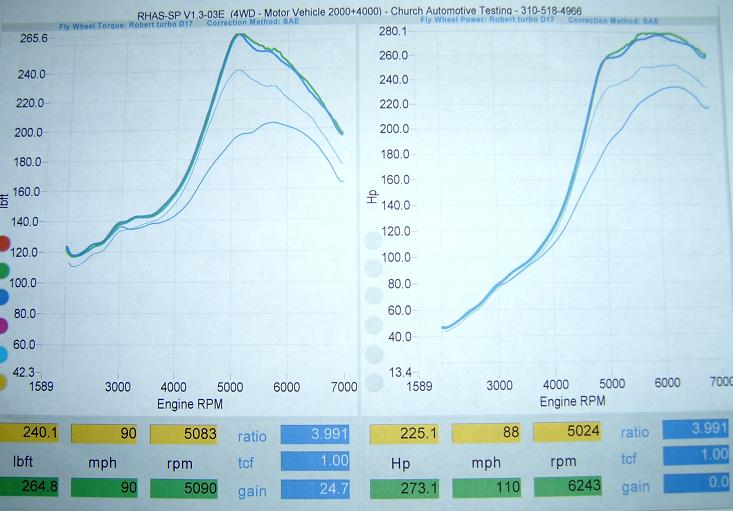

And the results are in!!!!
drum roll......
273.1 HP / 264.8 TQ @ 17 PSI
We have found the max for the stock fuel pump! Im going to put a walboro in and hit 300 no prob.

Wow.
Congrats man!
Now don't sell that setup!

Re: Results are in on page 10 @ 17 PSI
From a roll im pretty sure I could already take a stock evo or sti. Its scarry fast... seriously!
We did try for 19 lbs of boost and it started leaning out really quick even after bumping the injector duty way up it diddn't help

Dude, I thought mine was fast at 9 psi and whatever HP I'm making. I can't even imagine 17. This very good to know about the stock pump though. 17 psi and the stocker keeps up without issue. I would think that a daily driven 7-9 psi setup should be just fine with the stocker then.
I also think that running at 17 psi on the stock pump might cause it to wear out faster than it would running at stock fuel levels or more. But at least you found it out where it can hang till!
Ya I wouldn’t expect it to last that long running at 100% but it shows that there is no need for a return fuel system or pump unless you want more then 300 hp. I just added a boost reference to the stock FPR in the tank and everything works perfectly. The best part is that everything is completely hidden.
i just PMed you back bob.
Good times today. I dont know why it didnt save your 280hp run...it hit just over 280 right after the plugs were gapped and before you blew off the charge pipe. haha.
Send me the vids and ill post em up...its just too bad you didnt get me jumping my car. damn streets.
nevermind...it does show on the chart.

I sent you the vid. He diddn't save the 280hp run cause it was running out of fuel and wouldn't be reliable.
