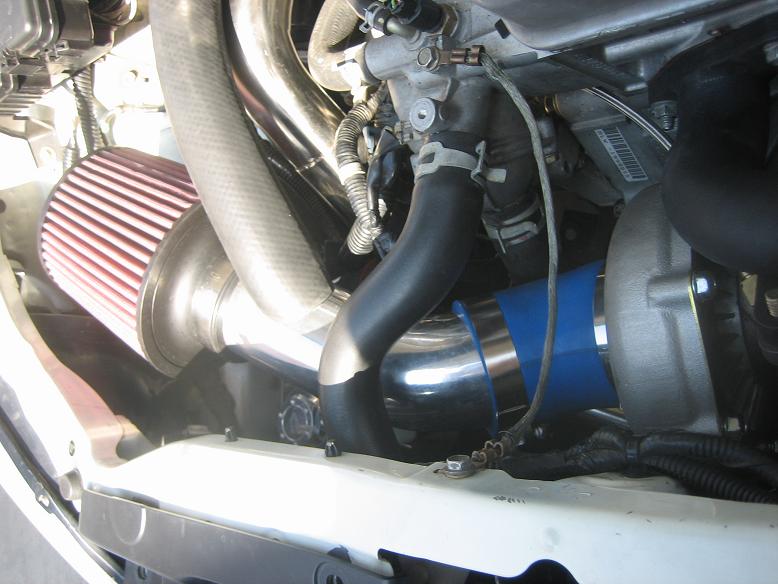

here is how i did my air filter
a 45 degree silicone bend and a 45 degree pipe so I could clear the coolant lines without reversing them...
