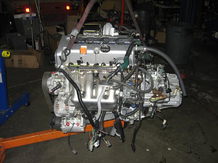

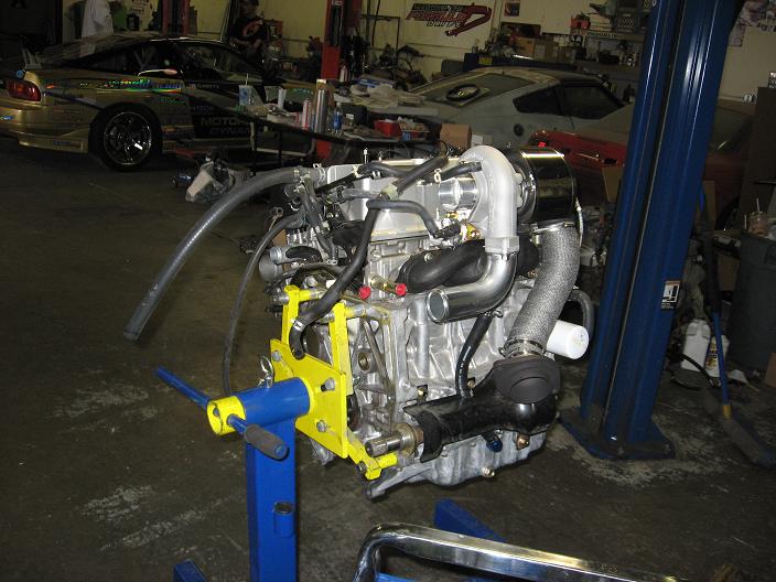

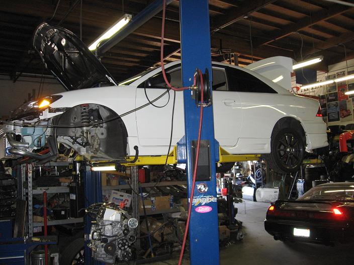

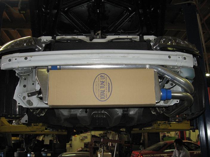

Hi Everyone,
Just stopped by the shop to take some pictures. They already dropped the motor, tranny and subframe. The battery has been relocated to the trunk. They also mounted the Greddy EP intercooler.
Thanks to Henry from the shop he made the auto-wrecker take back the first incomplete K20 and received a very clean one with 14k miles on it with matching tranny.

Old May 16, 2006
Curiouz_G's Avatar
Posts: 2,545
From: VA/MD/DC area
Rep Power: 288
Curiouz_G is just really niceCuriouz_G is just really niceCuriouz_G is just really niceCuriouz_G is just really nice
you are probably the 1st person whos doing a k20z1 swap on this site. and a FI one too. gl with everything and post numbers when your done

Talk about the newest of new swaps :-P!!! GL!!! post some dyno sheets after!! maybe a track time i wanna see how it works out

looks good! im loving the LSD in there 2.

I hate you
Good luck with the whole Drive-by-wire throttle system.

good stuff man...i see an nsx, mmm...

Sweet! Are those B+Gs?
Sure no problem...I'll post some dyno sheets!
Sure, I,m planning to hit Sacramento Raceway very soon after the swap!
Yes Sir, they are!
Originally Posted by HondaLuver
nice... hurry up !
Thanks man...and GL on your K24 engine build!
Thanks guys for the positive comments. I'm planning to stop by the shop again today to take some more pics.

what lsd?
I agree. g/l with that ... you'll probably need an 02-04 type S ecu (or an adapter harness), kpro, and 02-04 primary and secondary o2 sensors... along with an 02-04 type S throttle body and throttle cable =] ... I dunno ... let us know how it goes

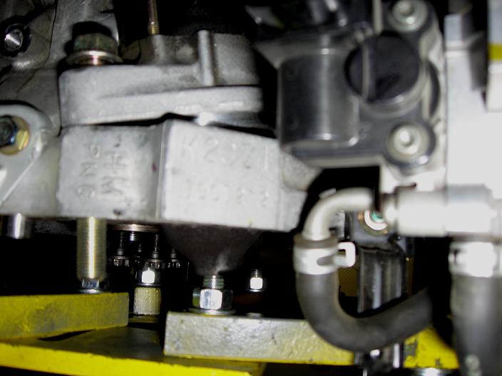

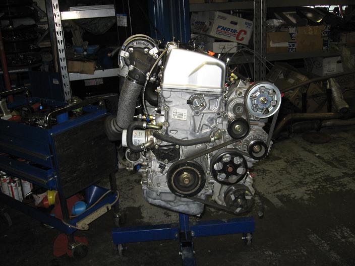

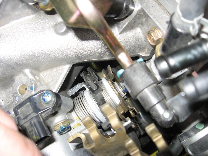

Well good news about the K20Z1...it still uses a throttle cable. Henry checked the new 2005-2006 RSX Type S's at the Acura Dealer and saw that they still use the throttle cable.

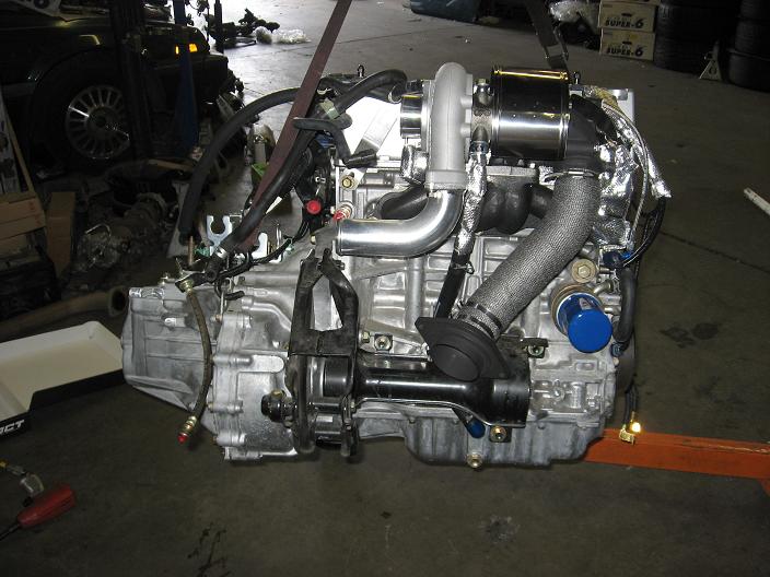

Here's a pick of the assembly. Looks like it can take a cable for the throttle and the other for cruise control.

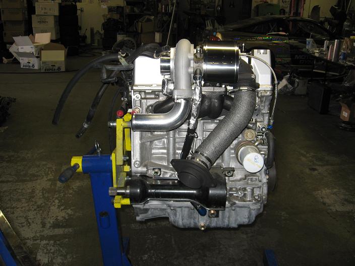

They are now installing the turbo on the motor. They are going to use some bolts from Nissan turbo cars because the Greddy bolts that hold the turbo to the manifold usually buzzes loose. Since the engine is out they are not going to use the Greddy oil-lines...but make some custom lines.
For now I have to use the 2005 ECU to technically pass when I take the car to the Ref here in Cali. Even though it may pass the sniffer they may not pass it because the ECU has to be the same year as the car or newer and the same year as the engine.
Will be using K-Pro in the future though.
I do have a few other items that will be going into this swap: Quaife LSD, ACT Lighten Flywheel, ACT 6 Pad Clutch w/ spring, ACT Pressure Plate and Type-R valve cover. http://www.7thgencivic.com/forums/sh...34#post3830334

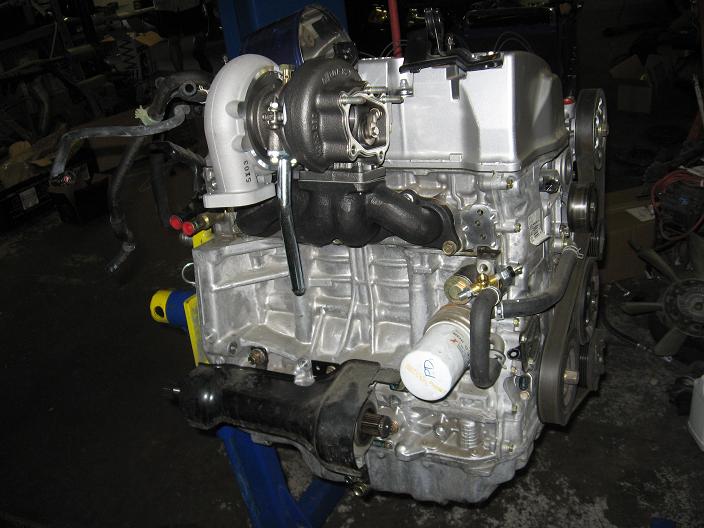

Hi everyone,
Stopped by the shop again. They are waiting to get a subframe in. They can't seem to location one yet. I may have to buy one from the dealer soon. They are now installing some material for heat shielding. Here's a few pics.
Thanks guys for the positive comments. I'll keep you'all posted.

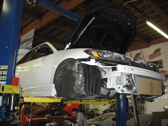

Hi everyone, just stopped by the shop again. The subframe came in last week. They did some work on the car today. The engine and tranny is put together and ready to be dropped in the car tomorrow.
I had to buy some stage 2 aftermarket axles because I couldn't find any OEM Si axles. Also picked up a Koyo Si aftermarket radiator.
Henry at the shop is hoping to have the wiring done by this weekend. I'll keep you all posted. Here is a few more pics.
Even if you had found OEM Si axles, You would probably be upgrading to aftermarket axles after the first pass you got traction

That's awesome man. The shop doing the work looks like they're pretty competent. I don't know of any shops here that would be able to do a swap like that.
Anyways, can't wait till it's done...

yea it's a bitch finding axles and a subframe, i can already see problems with the speedo and the wiring harness, and kpro... unless you downgrade to 02-04
