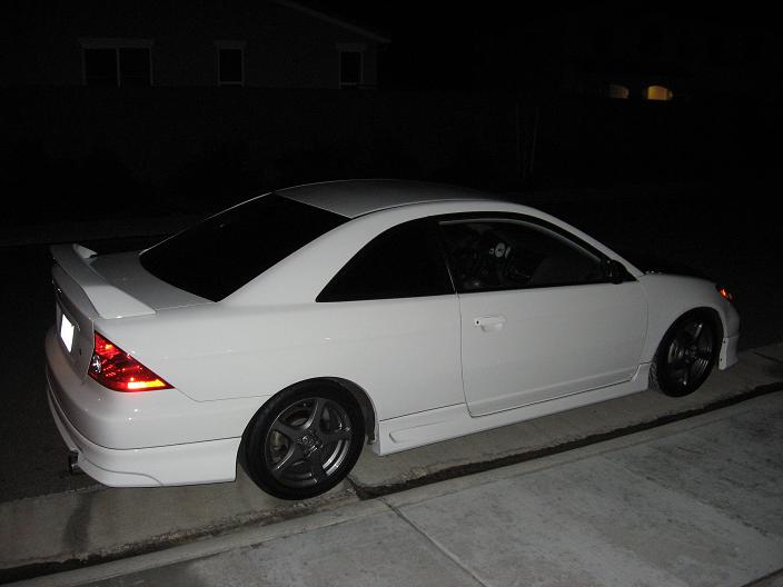

Sorry I have been gone for a while from this tread. I had a set back about a month ago. I hit something on the road and it took out all 4 Centerline wheels with two blowouts, my secondary O2 sensor and blewout the shock tubing from the top base of the coilover.
Since it's winter I went to a 16 inch wheel. It's the Honda 5 star 16x6.5 wheel with some sticky Hankook Ventus Rs2 Z212 205/50R16. I also replaced the B&G coilovers with Funtion Form Type 1 coilovers.
With this combo the car rides and handles much better than before. The tires have a 200 treadwear rating. Now just have to feather 1st gear and hammer second gear depending on the condition of the road. I have not adjusted the setting yet but the Funtion Form Type 1 coilovers are a major improvement over the B&G's. I can feel the grip of these tires and the car doesn't rock back nearly as bad as before.
Before I had to feather the clutch from 1st to 3rd gear with 300 treadwear rating 215/35 18 tires which were Toyo Proxies 4. Then with 280 treadwear 215/35 18 tires I had to feather 1st and 2nd gear. Both of these set ups have been with the B&G coilovers which were pretty soft in the back.
I'm hoping to hit the track within 3 weeks. I'll post some vids also. I did't have a chance to work on the Speedo issue yet. Here are a few pics of the car with the new wheels and coilovers.
