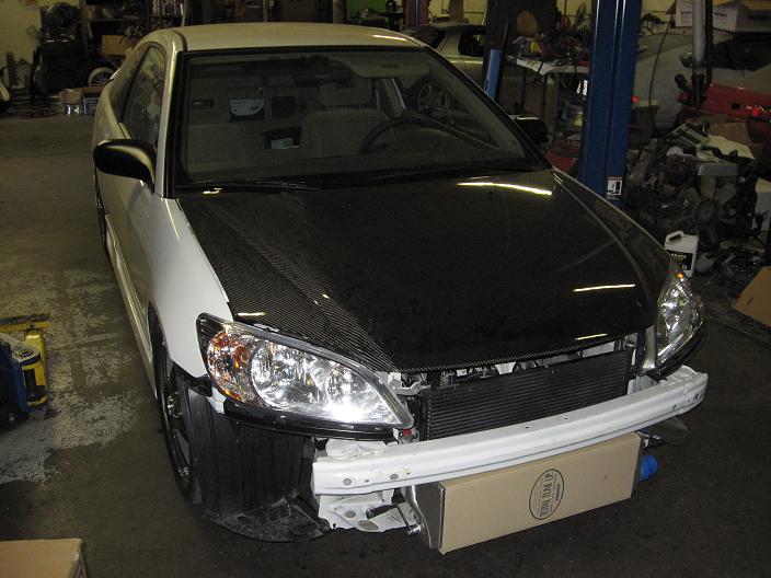

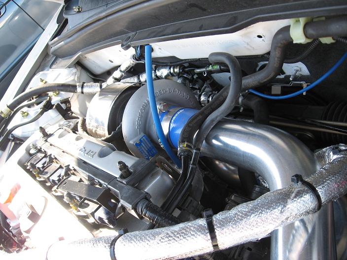

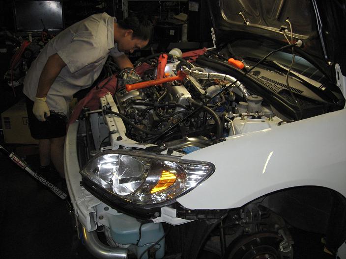

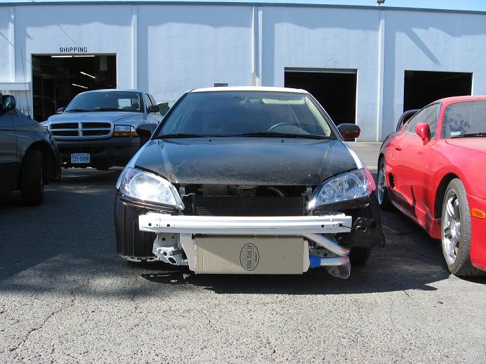

Hello everyone, I stopped by the shop again today and they now have the engine mounted. Now they are getting ready for the plumbing and wiring.
Here are a few pics I took while they were finishing up. The first pic Ray was bolting down the last mount on the passenger side. Second pic the engine is bolted in and the last pic is the hood almost all the way closed.
From reading from the past posts on swaps I notice people had to cut part of the hood to clear the power stearing pump reservoir. Did any of you have problems with the pump itself clearing? The pump itself is what keeping the hood from closing in the last pic.
Also it looks like I'm going to have to ditch the windshield washer tank since it in the way of the intercooler piping.
Thanks for your support and I'll keep updating.

damn man, you beat me to what i was going to do. Except i was going to do a k20a3 with turbo, since its cheaper. Where you located? are you located in so cal? if you are, which shop are you using? I need to find a place that does clean work.

Wow, tight clearance, but looks great in there. The hood is dope

i ditched the washer fluid, and its where the PS pump pulley is that you have to cut away on the hood.

Cool, thanks man! I was under the impression that the hood needed to be trimmed for the resivour. Hopefully I can catch the guys at the shop before they start trimming away. I rather get the EP electric power steering.

tell the guys at the shop to not trim anything till the motor is actually running.. then wait to see what part of the hood the motor hits...

Thanks cubanmike26! They had to bring in the motor from the bottom of the engine bay because of the turbo on the engine.
Thanks xproductionz! That's a good idea.

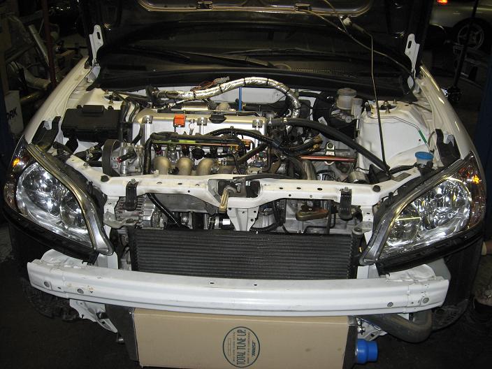

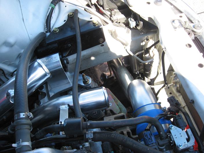

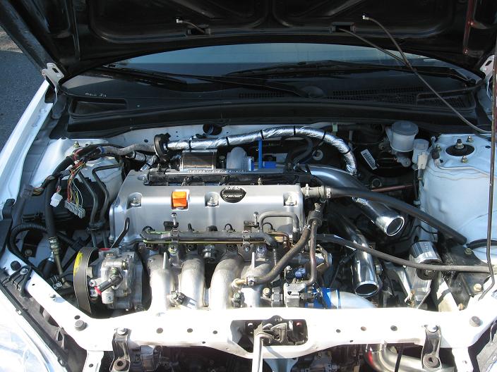

Hi everyone, I stopped by the shop yesterday and took some more pics. They have the shift linkage hooked up and some of the intercooling piping hooked up.
I can see they started doing some work on the wiring around the glove box area.
The guys at the shop check an EP they had at the shop to see if it was possible to do the electric power steering rack. They said it won't work for my application because the turbo is too close to the firewall.
Here's a few more pics. Thanks for all the positive coments.

Opps here are the pics.
