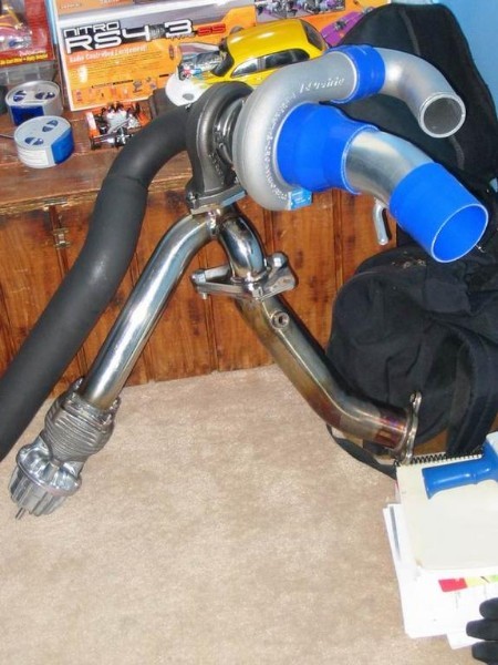

so the wrx my friend and i are building needs help on the size of the turbo to get. right now we are looking to get the greddy T67 kit for the STi. word around town is that this turbo is to big for the 2.0L to push. spool up will be slow but top end power will make ur eyes water. so is there any other size turbo that is in the middle of this range. XS engineering has 2 turbos that seem to do the trick. T04S and the T04X
so those with knowledge of the T67 and whether it is capable of performing like we want to. please chime in

I can think of a couple of other nice turbos for that app too....What are the driver's intentions and goals? 4dr is right........GT28 would be an OK turbo for that app, I think I can do a little better......

A Garrett GT35R or GT35R based turbo would be optimal for you based on your requirements. A GT28RS would be too small.

if you dont want ot wait for spoolup, get something like a GT35R or a 62-1

we are going to try and make up for the displacement with the head and port work, also the intercooler piping is going to be different sizes in order to create some more velocity.
www.dprracing.com they have some SICK **** for WRX, but then again its baller status to have them do the actual labor, of which aint happening, bc the WHP per dollar does not logically justify the money spent, of course unless u got grands to blow. like i said an INTERNALLY GATED TURBO is not in the picture what so ever
we were also looking at the ESX WRX in the last few issuses of DRAG and TURBO, dude was pulling around 8-900 hp on a stock manifold, yes we called about it. so we are going to stick with a stock manifold. we are going to have the exhaust housing of the turbo ported and jet hot coated.
here is the real kicker. seeing as how i work for the shop that is doing all this work on the WRX, of which the amount of work i do is quite little, basically i just sell to my friends. this kid being the main one. ANYWAYS once this deal is signed sealed and delivered DONE. i get a free sleeves, free labor and motor rebuild.

have u ever had ur eyes roll back in ur head from the shear force of stomping the gas pedal. guaruntee u it will make the cover of a magazine when its done, shop has already had one in there, so what is another one.
im still stunned at the comment i quoted, im shocked and speechless
