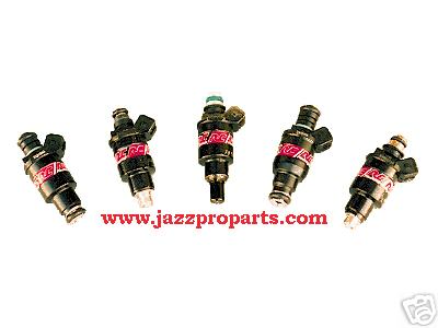

INJECTORS: Upgrading injectors is a must. Our stock injectors are known as 240cc with a capacity of 3 to 4 psi or 50 shot of nitrous. You can upgrade to a rsx injector which has a capacity of 320cc (((some members have had there injectors flowed and came up with results of up to 340cc on rsx injectors but this is the basic so you dont push limits and this is what we flowed them at))) These injectors are good for 8 to 12 psi max or 100 shot of nitrous max. You can order bigger injectors of any cc you need. RC engineering will custom make them for about 400 shipped. (((321-639-3288 ask for Junior))) Just upgrading the injectors will not be suficient. You will also need to upgrade the next part we talk about.

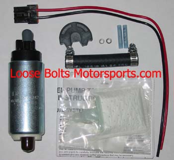

FUEL PUMP: Your stock fuel pump needs a little help. You can put a inline fuel pump to boost your fuel pressure or you can replace your stock one with a better one or completley get rid of your stock one and get a high pressure inline one. Anyone of these is sufficient for the amount of boost your stock internals will hold which is a whole different subject.

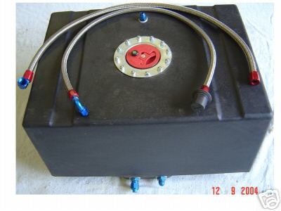

FUEL CELL: You can get rid of your stock fuel tank and mount this in your trunk or where your stock one is. This is for you serious people like me, but it is not neccesary at all. It makes it a lot easier to to a return line which is the next part.

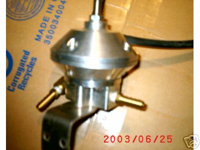

FMU: An FMU works by upping your fuel pressure in your fuel system when it senses boost in your intake manifold. For example, you can set the adjustable ones anywhere from every 1 psi boost it ups the fuel 1 psi and they usually are adjustable up to every 1 psi of boost ups the fuel 20 psi. Set FMU's come with a preset setting that is somtimes interchangable. On a returnless system before the fuel line enters the fuel rail it is ran through the FMU then to the fuel rail. It holds the needed pressure in the fuel rail. On a return system the fuel line is ran through the fuel rail then through the FMU then back to the fuel tank. This keeps the fuel pressure up in the rail before it goes back to the tank. It has a vaccumm line ran off the intake manifold to read boost and vaccumm. If you have an FMU it is not neccessary to upgrade you fuel pressure regulator unless you dont have one of the options listed under fuel pumps.

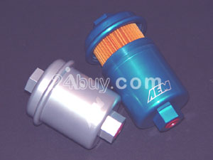

FUEL FILTER: You do not need to upgrade your fuel filter unless you want a better one or you get rid of your stock fuel pump.

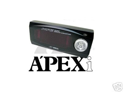

FUEL CONTROLLER: You have a couple of options here. You can add a vafc2 to control the fuel (((to tune this clink on the links for help))). You can add a piggyback system (((Greddy E-Manage))) which wires into your stock computer also known as ECU to controll extra injectors. You weld one or two bungs about 4 to 6 inches away from the throttle body in the charge piping and they spray extra fuel in the motor when it is needed. This works but is still not 100%. The Greddy E-Manage can also trick your stock computer or add comands to the command list to control fuel which is better. The best way to go which is also the most expensive is to switch the whole computer completley to a S.D.S. (((Simple Digital System))) or another good stand alone system. This wires into your stock sensors and gets rid of your stock computer completley. With this you can program the whole range of fuel air, timming and everything, but a dyno is needed. A dyno is needed to properly tune any setup to a 100%
