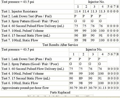

I had mine cleaned & Flow tested at Cruzin Performance for like $56 Shipped, these were my results:
To convert from lb/hr to cc/min, simply multiply the lb/hr by 10.5.
So for mine the average was 31.39 * 10.5 = 329cc
But Opto got 340cc? What would the difference be?
If you are going to be adjusting the fuel pressure, you can use the following formula to calculate the approximate fuel flow when adjusting the fuel pressure up or down:
new flow rate = (rated flow) * square root of(new fuel pressure/rated fuel
pressure)
Here are my results

That seems to be about 323cc on average then. Seems to be differences, or is it in the way they were tested?
It would be safe to say they are 320CC injectors. Error margin is in the users favor if more.
