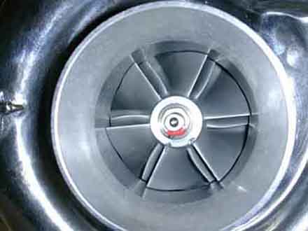

intake compressor
Name:	intake compressor.jpg

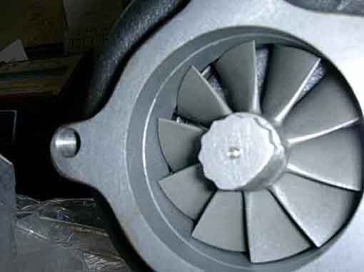

exhaust wheel
Name:	exhaust propeller.jpg

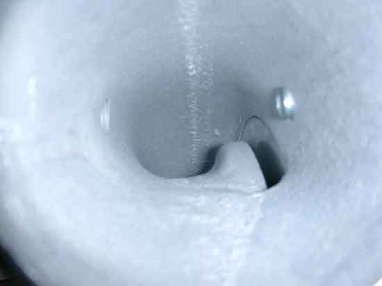

exhaust housing inside
Name:	exhaust inside.jpg

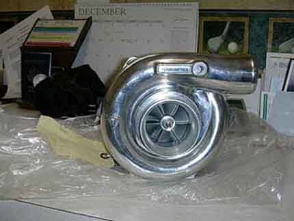

the turbo itself on my desk
