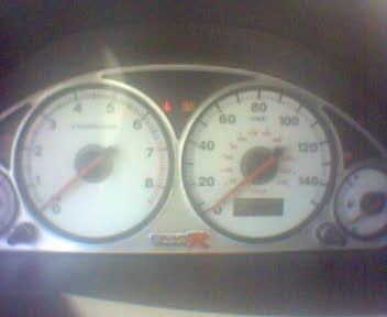

Push and hold the trip button
Turn key to accessory position, when the gauges light up
Wait about ten seconds until the MRL goes out.
Turn off key
Something like that
