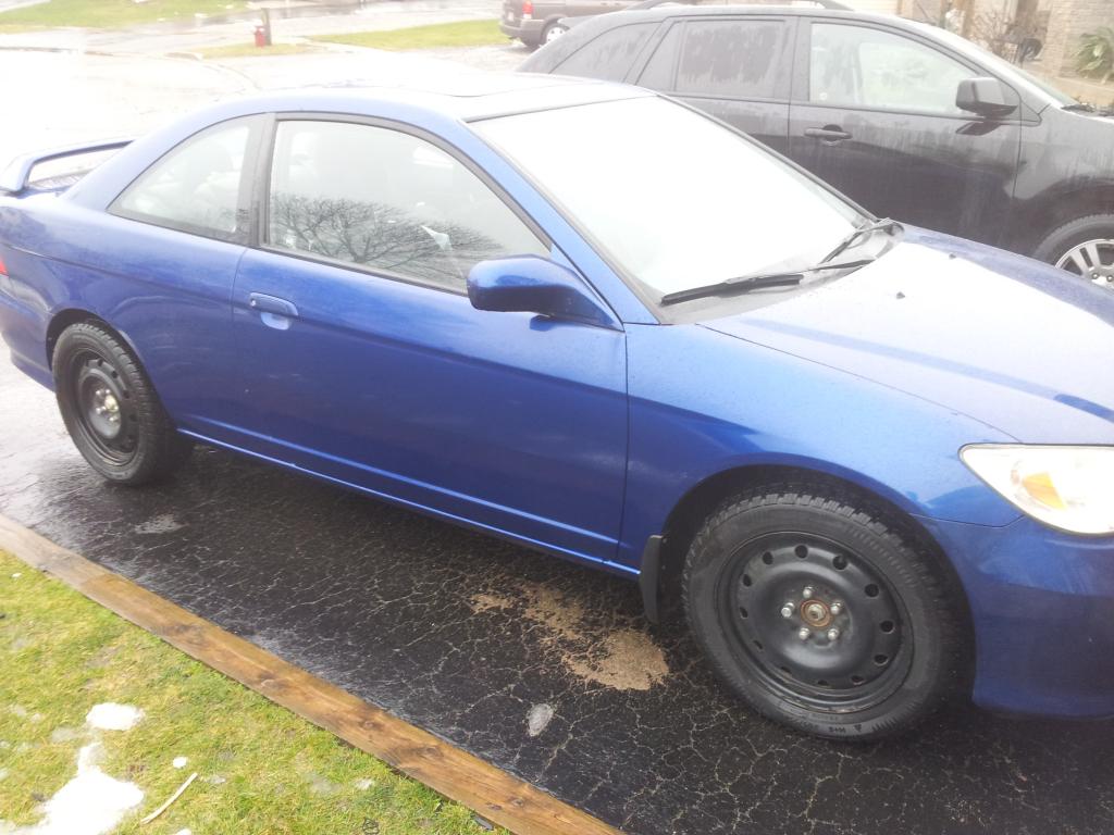

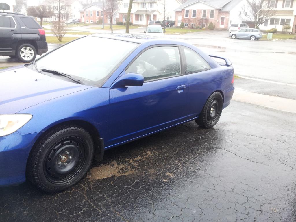

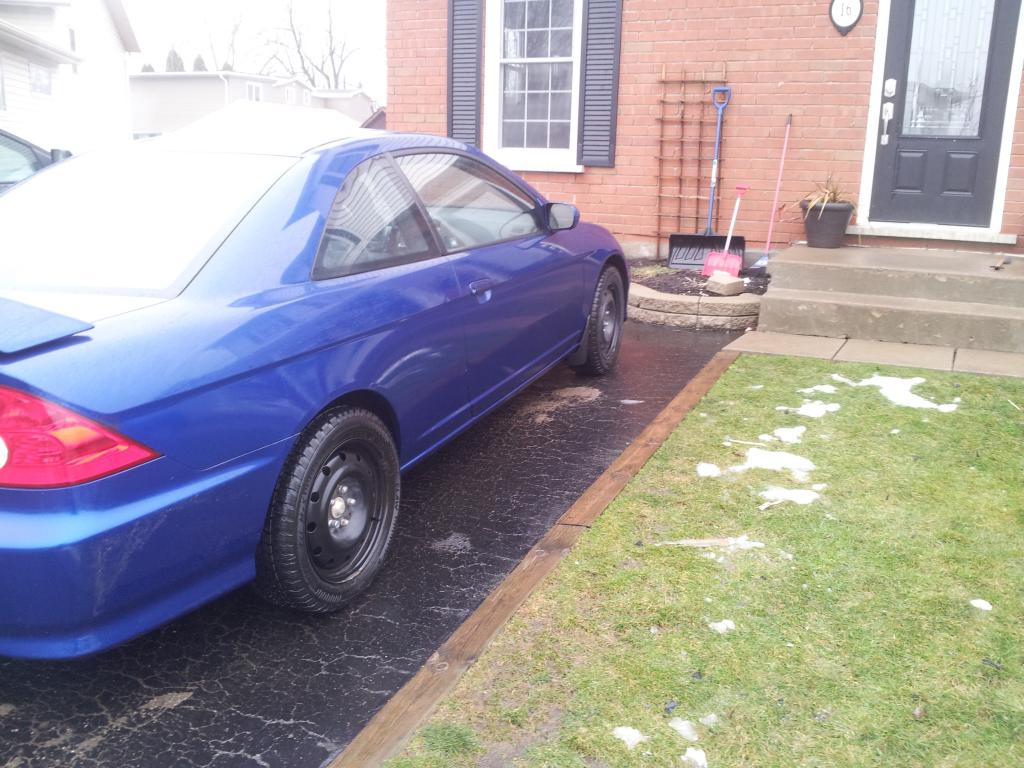

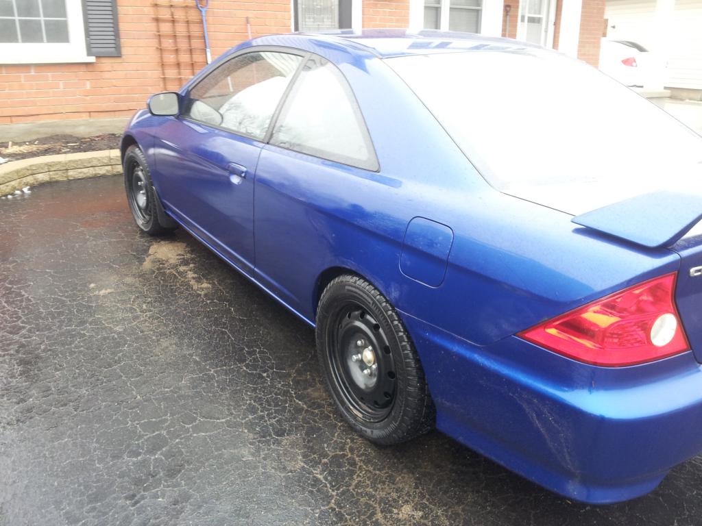

5 lug swap complete with DC5$ rear end, fenders rolled.. Off to the body shop for some fender paint tomorrow to finish it all up. Just need to get a camber kit and adjust the camber a little bit more the negative way so it does not hit the bumper bolt any more and I'm finished. Back left shock is sagging real bad, on stock suspension!!! The car rides smooth as hell... Steelies on for now:

you know, my vic have the left side lower too. until i corrected cambers, alho it's still slightly lower on left side (and no, i did not eat too many macs... 110-120lbs)
darn, the rears are really sticking out quite a bit (hey, you said they would be to the inside?!? )
yeh gonna need to put some -3 deg in the fronts so you will not shoot straight in that snow covered corner - time for a 28mm rear sway bar, then

Sick as a dog here. Once I feel better I'm going to try and bend the tab that the rear bumper bolt sits on so the tire stops hitting it. Unless someone knows a better way to fix it because I'm pooched right now. Hitting pretty hard when the tire reaches it.
