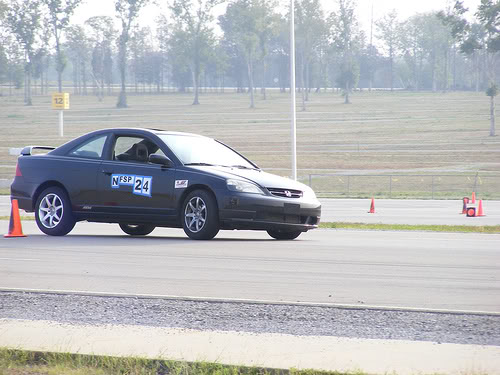

Thanks for the heads up on the HPS pads, too. I do have gunmetal rims, so it hides brake dust nicely. I can't tell until I run my finger across it. That's kinda weird though because they claim low dust..
they are lower dust than the racing ones.
on separate note, i had gunmetal wheels in front and silver in the rear until i cleaned the fronts, then they were silver/silver
Here's one mid-way to gun metal fronts...
