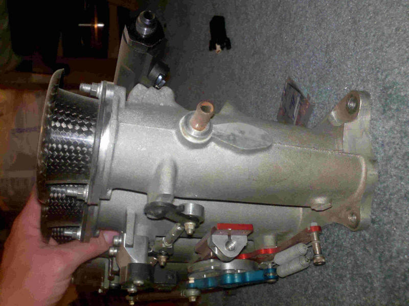

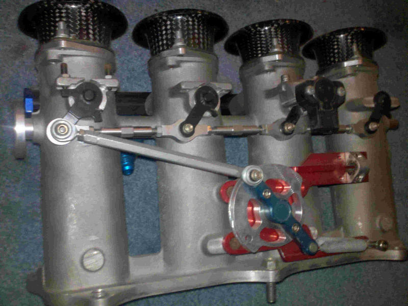

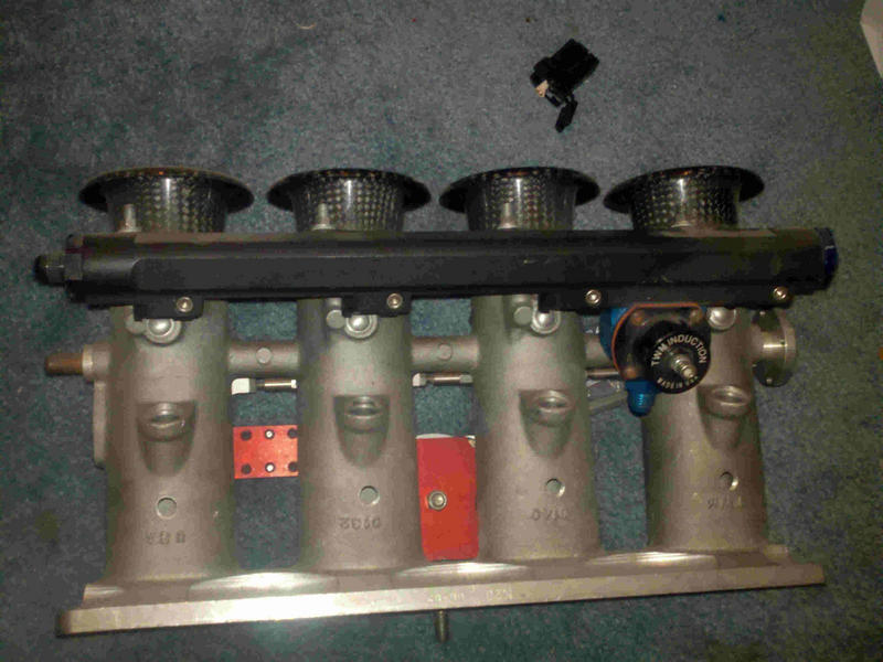

need some help. i am about to get everything together and need to figure out how to install my itb. twm induction. i know i'm missing injectors but i need to know what's up with the vacuum lines, map sensor and iat. also what do i do with the lines that are coolant lines from the stock intake?

I can't express how much I love itbs on a k-series, with the intake pointing at you... sex
If you want my honest advice on questions about installing them, go ask on k20a.org..

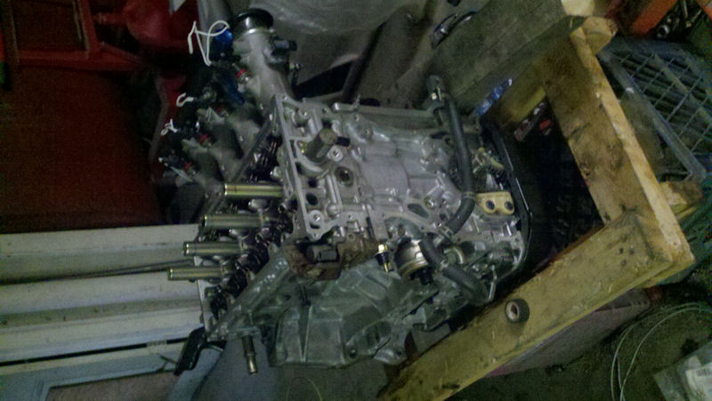

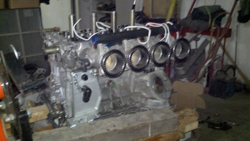

well got the injectors and after some headaches with the oil system. i'm finally almost done. all i have to do is set the timing and get the valve cover gaskets.

looking good

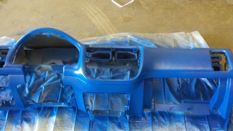

vinyl dyed dash and some other interior peices today

Not sure if I like the blue dash. Everything else looks awesome.

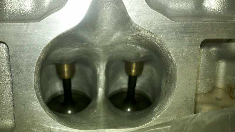

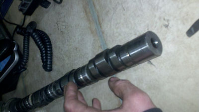

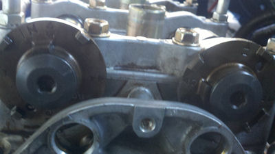

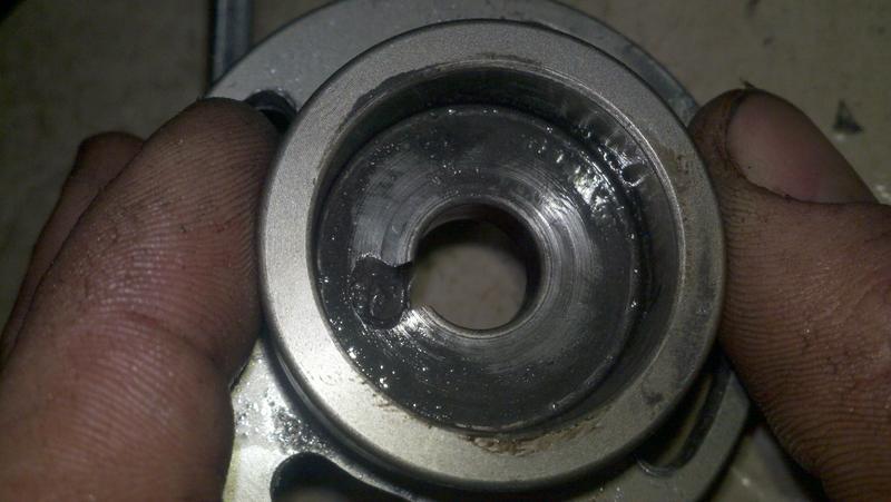

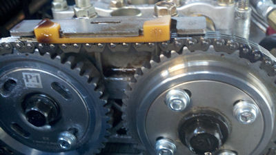

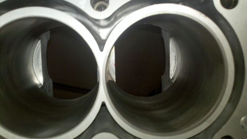

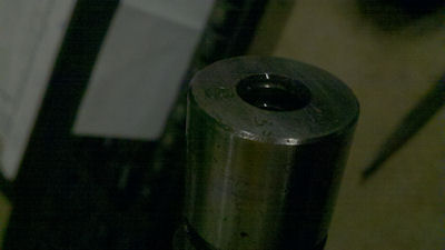

I have a problem with my JDM K20a Build. After installation, the exhaust cam gear and my exhaust camshaft have broken. After work today I tried to start my motor. Unsuccessfully, it would turn over but not start. I logged into KPro and found no codes or electronic fuel, spark or timing issues. After pulling spark plugs revealing no burn on cylinder 1 and 2, having burn on 3 and 4. I then did a compression test to which cylinder 3 and 4 had good compression but 1 and 2 would not compress. I knew then that there had to be a timing issue. I took off the valve cover and as you can see from first glance TDC and timing are fine. After closer inspection I had found the the exhaust camshaft/gear had spun somehow and were on cylinder 3 at TDC and Intake was at cylinder 1. Tomorrow I will be pulling my head off to see if the valves have bent, pistons gouged, ect.
