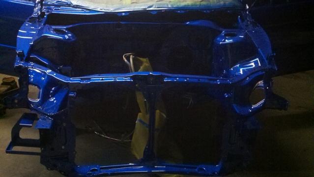

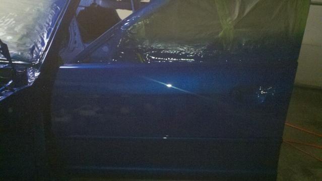

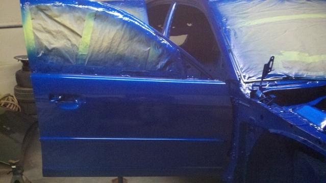

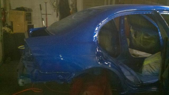

Here's the paint. Head pics tomorrow. Block out getting bored to 89mm

beautiful. its like glass

thanks. it's 03 PT Cruiser electric blue. its got 5 coats of clear with 2 base under that is 3 primer. alot of primer due to sanding and fixing the stupid lines left from the sand blasting. started the headlight harness tuck and fuse box relocation today. got an idea of how to start it. put in sunroof, eps and subframe yesterday.

You can tell that it has five coats of clear, the paint has so much depth.
Where are you relocating the fuse box to?

the fuse box is going in the wiper cowl passenger side. where the cabin filter inlet is supposed to be. i pulled the a/c, blower and heater out already. the headlight wires go through the sunroof outlet behind the fender. did the passenger side today. when i finish the driver i will post pics.

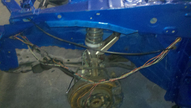

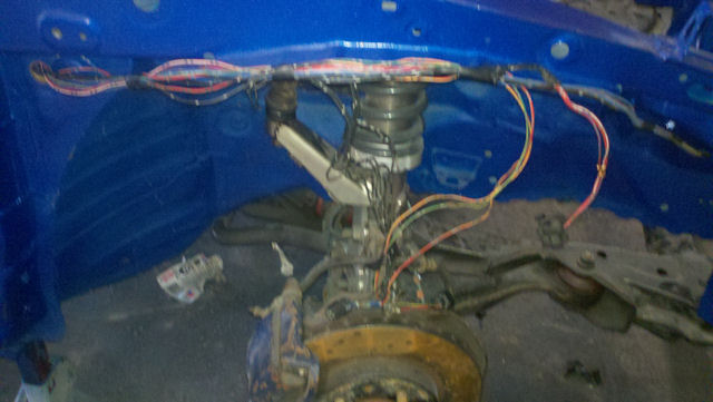

body harness tuck

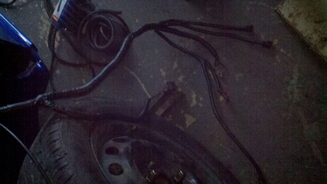

here is driver side tuck loomed up. passenger tomorrow i hope. i also wired up the water/meth injection kit and fuel pressure gauge.
Ya i can still make some progress as i have most of the parts but need money for minor things. like new door seals and prop valve.

so wait your k swapping and putting meth in? are you turboing the k? or can you use meth/water injection on an N/A car?

Quote:
What prop valve are you going to be using?

Meth on N/A Itb setup. Prop valve from 02 Vic DX
