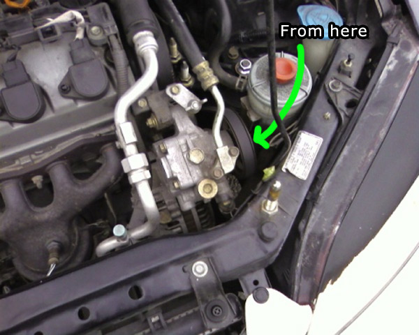

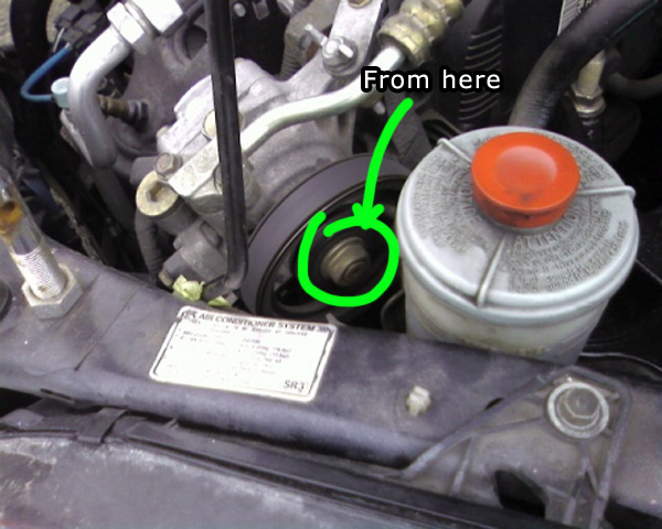

Can you help me figure out this noise?
Since I just replaced the Input shaft bearing in my transmission, I no longer hear that annoying rattling/scraping sound that came from the bad bearing.
Now that there's no noise coming from the transmission, I can hear something else coming from the engine bay. It sounds like a metal fluttering noise, almost like the sound of another bearing. I can hear the noise on two occasions, one, when I'm driving in gear and I let off the gas and just let the car coast down the street in gear, I hear the noise. And Two, when Im just parked in neutral and I rev my engine, as the rpms fall I can hear the same noise.
I got under the hood and revved it up. I think I found where the noise is coming from. Pictures attached....
Sooooo, what is that thing and what does it do? Think it's something I can just grease? Or replace myself?
Any comments or info welcome and appreciated.
THANKS!

power steering pump, not realistically serviceable but fairly easy to replace

Not to mention that it really really sounds like it's coming from the right side of the engine bay, almost 100 percent sure it's (what Tfnaaf says is the power steering pump ) that thing on the right.
Sweet thanks for the info.
Hondapartscheap.com wants 250 bucks for the whole assembly.
Think I can just grease it up?
Has anyone does anything like this before?
Edit: The bearing is like 9 dollars, do you think It can be replaced? (instead of buying a new assembly)

Stop. Before you **** with the PS pump, take the belt off and see if the car still makes the noise when you run the car. If it goes away, then continue on with trouble-shooting the pump, if it doesn't then we've opened up another can of of worms.
The pump is semi-rebuildable. My pulley nut spun off last year so I had to replace both the pulley and the spindle. I think it cost me all of $16 for a new pulley, shaft/spindle and nut. Taking the pump apart isn't very difficult and might be worth it.

I'm like 99.9repeating percent sure that it's coming from the PS pump belt assembly, because when I rev the engine I put my ear up to the pump and it sounds like it's coming from there.
I'll try the beltless idea and go from there.

OK! so here's what happened!!
I took the power steering belt off, and yeah I could still hear the noise!
The noise was still coming from the same area, and what's right near there? The Alternator belt. So I got under there and loosened one of the mounting bolts, and fought like hell to get the other one loose, but nope, even after soaking it with pb blaster, didn't budge a single millimeter. I didn't know what to do so I just thought I would tighten everything up and tackle it some other time. (I had other things to do.) After I tightened everything up I jumped in the car turned it on and.....
The noise is gone!
Ha ha I thought is was funny because I feel like I didn't do anything. I tried to adjust it, but couldn't then it's fixed! Weird....
I'm guessing whatever I did was just enough to get it to shut up.
Sweet. Now I'm happy with my car again. It hasn't been like this for about a year or two! crazy!
