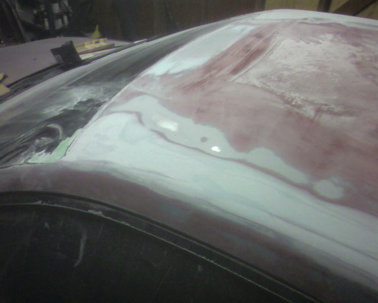

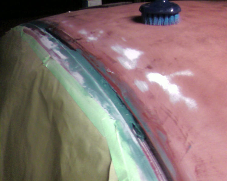

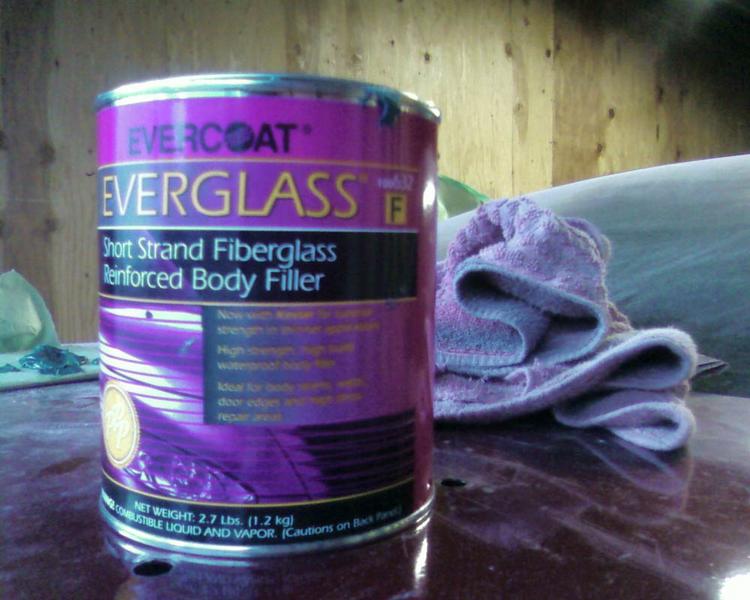

Alright, so here's another update, tonight I've pretty much just been filling the rain grooves on the roof. I want a sleek look, so I'm trying to get it flattened out. Also I block half the car with 180 to flatten it more.
Here's the filler I used to fill in the grooves, It's re enforced with kevlar.
Filling
Filling more, but not done sanding yet.
Up next I have to repair the kit and block it out.....more to come!

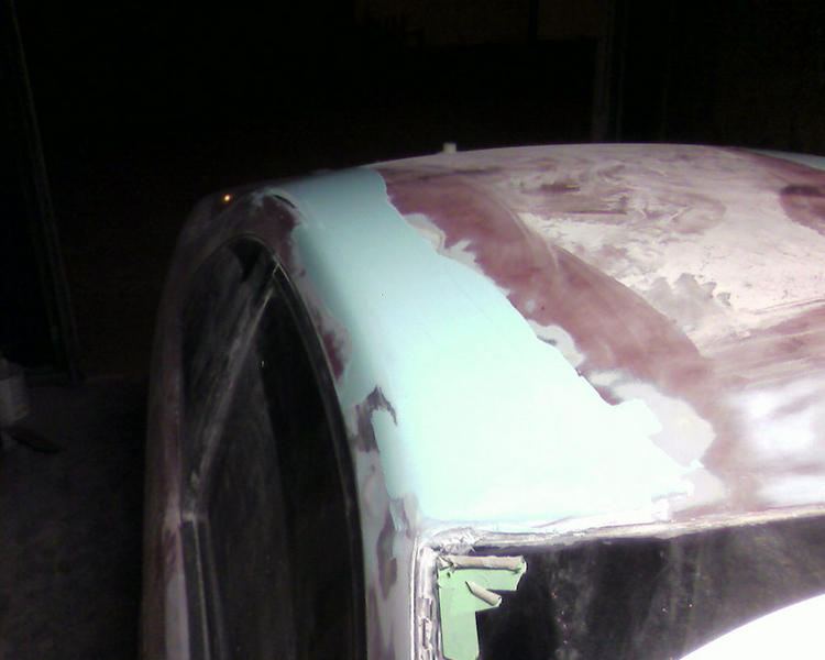

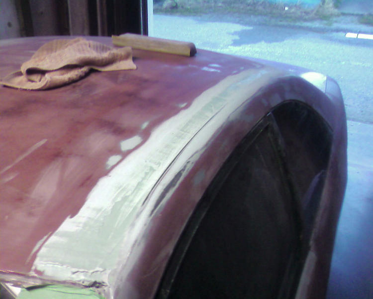

Update; continued from yesterday:
I kept working on the roof, it's looking/feeling really nice now. more pics:
(All i have to do is Sand the final glaze and then prime it for now....)
Ya think? Ha ha. It's all good.
That's it for now, I hungry as a bear and need to relax, tough day at work and lots of work in the garage. This weekend will be nice though, I'll have time to work on it. And even monday is cool too because I'll be home all day.

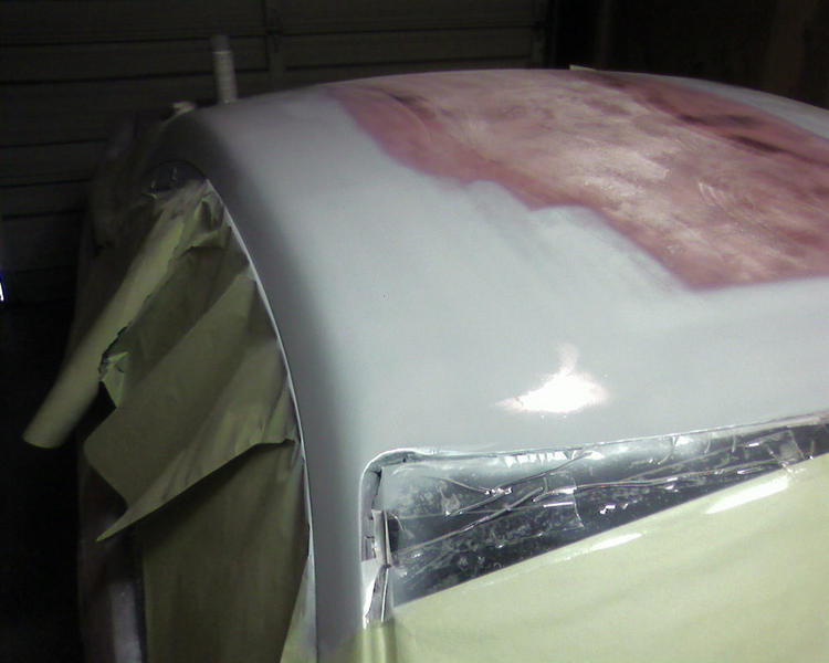

Saturday update:
I blocked out the finishing glaze and damn yo....it's friggin smooth as glass. That's what it's gotta be like! Ha ha, I'm glad I put so much time into making it look nice, because it's gonna turn out nice in the long run.
So Im done with filling the grooves in the roof, but I still have to block out all the low spots in the middle area of the roof...oh well, as least the harder stuff is done.
Here's a picture of what it looked like when I completely flattened the finishing glaze.
After that, I just masked it up and primer-ed the hell out of it!
In these pictures, the primer is still wet, so you can see light reflecting off of it.
