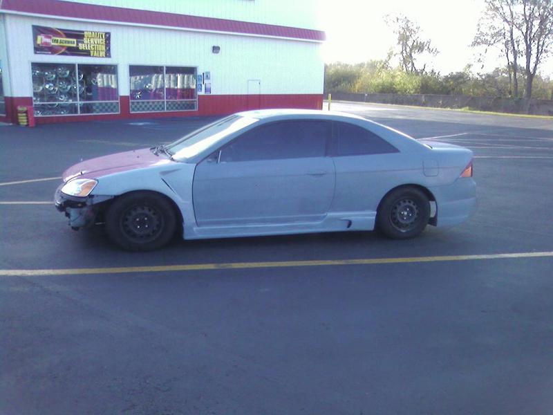

Ok here's another update:
To make a long story short, no one could get me into a booth for primer, even when I was ready to pay them to do it for me. So I had this guy from this performance shop down the street do it for me, and well, they're a mechanical shop not a body shop. So the point is, that it sucked, I wasted money, I moved on. The good news is that I got most the car primer-ed and so now the bare metal is protected. Check out this one new pic. I'll take more another time. The roof turned out really well which is tight because I was expecting it to look strange.
No front bumper yet. it's really messed up and I need more money and what have you etc.
Interesting change of plans:
I wanted to do white, buuuuuut the more I think about it, and yes I think about it night and day...heh, I just don't think that white is the kinda car I would drive. It's not white white, but white with gold, yes but For some reason I'm more interested with having a darker colored car.
Kustom Shop just came out with several new lines of paints, which are friggin just as good as like House of Kolor and what not. I think I want to get a Black Cherry Kandy basecoat. And then a set of Gold Volk GT7's (Which uncle sam will hopefully pay for when I get a tax refund next year.) Here's a photoshopped picture of a sweet NSX with the color scheme I'm thinking about:
Pretty sweet.....
There's no color chip for the Black cherry yet, on the Kustom shop website. But I did speak with them over the phone about what it looks like. So hopefully it'll be sweet.......

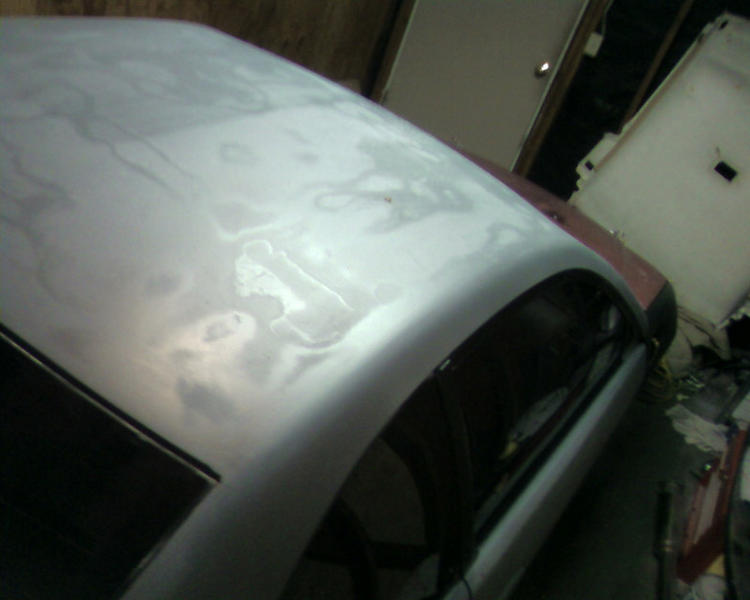

I kept working on the roof, it's looking/feeling really nice now. more pics:
(All i have to do is Sand the final glaze and then prime it for now....)
Ya think? Ha ha. It's all good.
That's it for now, I hungry as a bear and need to relax, tough day at work and lots of work in the garage. This weekend will be nice though, I'll have time to work on it. And even monday is cool too because I'll be home all day.
did you use bondo or something in the picture be cause it looks really glossy. Looks good by the way just asking becasue i used it when i shaved my front license plate off my car.

Re: Exterior build thread by Eyger (color swatch pics added! pg. 2)
I used Marhyde finishing glaze. The picture I posted, is when the glaze was still wet, when it dried, it looked much less glossy. It's cool though, sanding glaze is my favorite part, because it's so smooth. I read your Diy back when your first posted it, about the front shave, I liked it. I think it's a great mod, simple, but makes a hell of a difference. The only difference between me and you is that you had air power! I had good ol human muscle power!

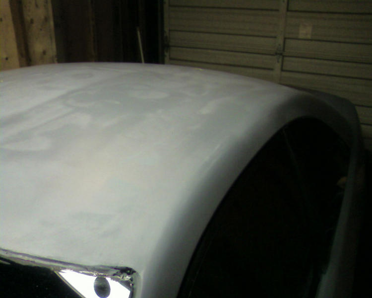

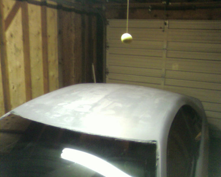

ok ok, some more roof pictures. You can clearly see where the body filler soaked up the primer. I partially blame it on the guy that painted my car, because he didn't do what I asked him too, any ways, check em out. More updates when I get a second job, or a new higher paying job.
I have a feeling I might be able to get all the materials together next february. Being that I'll get a phatty tax refund and I'll get 3 paychecks that month. So it'll be bitchin. Still no updates as of late. You'll hear about it when I'm back up and running.

Re: Exterior build thread by Eyger (90% primer-ed, thinking about another color...)
hey i have a question for you, mabee you'll know...
the rear bumer, there are two screws right behind the wheel to hold the bumper in tact (they're at the top). i need to take em out, cuz my wheel is rubbing on them (215/50/16 tires)
so, i want the literally glue my rear bumper on to my car (also plan to mold it on to my car so its one peice...but thats later)
what adheasive would u recomend? i was thinking JB weld! lol but im sure thats not the smartest thing in the world...but its sure damn strong.
I have the perfect solution for you. And I've been through all of this before, so you can trust me on it. My first car was full molded body kit.
if you want to mold anything to anything, purchase 3M's 3118 two part panel bonding adhesive. My buddys car back in the day used it to mold his kit and it's the best adhesive i've ever seen. The only draw back is first you have to purchase the gun, manual or pneumatic, either way, and second, it's pretty expensive stuff. Although you don't need all that much to get the job done. It's an adhesive not a filler. So after you got everything together, you fit the rear bumper in place, use the gun to lay a continuous bead of the panel bonding adhesive and sandwich the bumper to the quarter panel. Let some of it squeeze out. Wipe excess off with a finger using a rubber glove or a plastic scrapper then clamp the $h!t out of it and let it dry, i think it's like 24 hours of something like that. when done, apply regular body filler to make the gap flat, easy as that. This stuff is definitely strong enough too. 3M made it originally as a panel adhesive to use when welding can't be don't I.e. fiberglass, thin panels etc. remember when you mold your body kit, you can never get it off. Molded kits are really nice though IMO if you have any other questions PM me.
