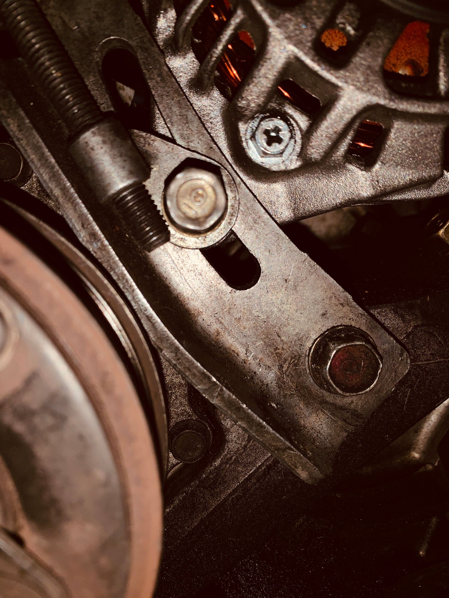

and you’re referring to these two bolts?

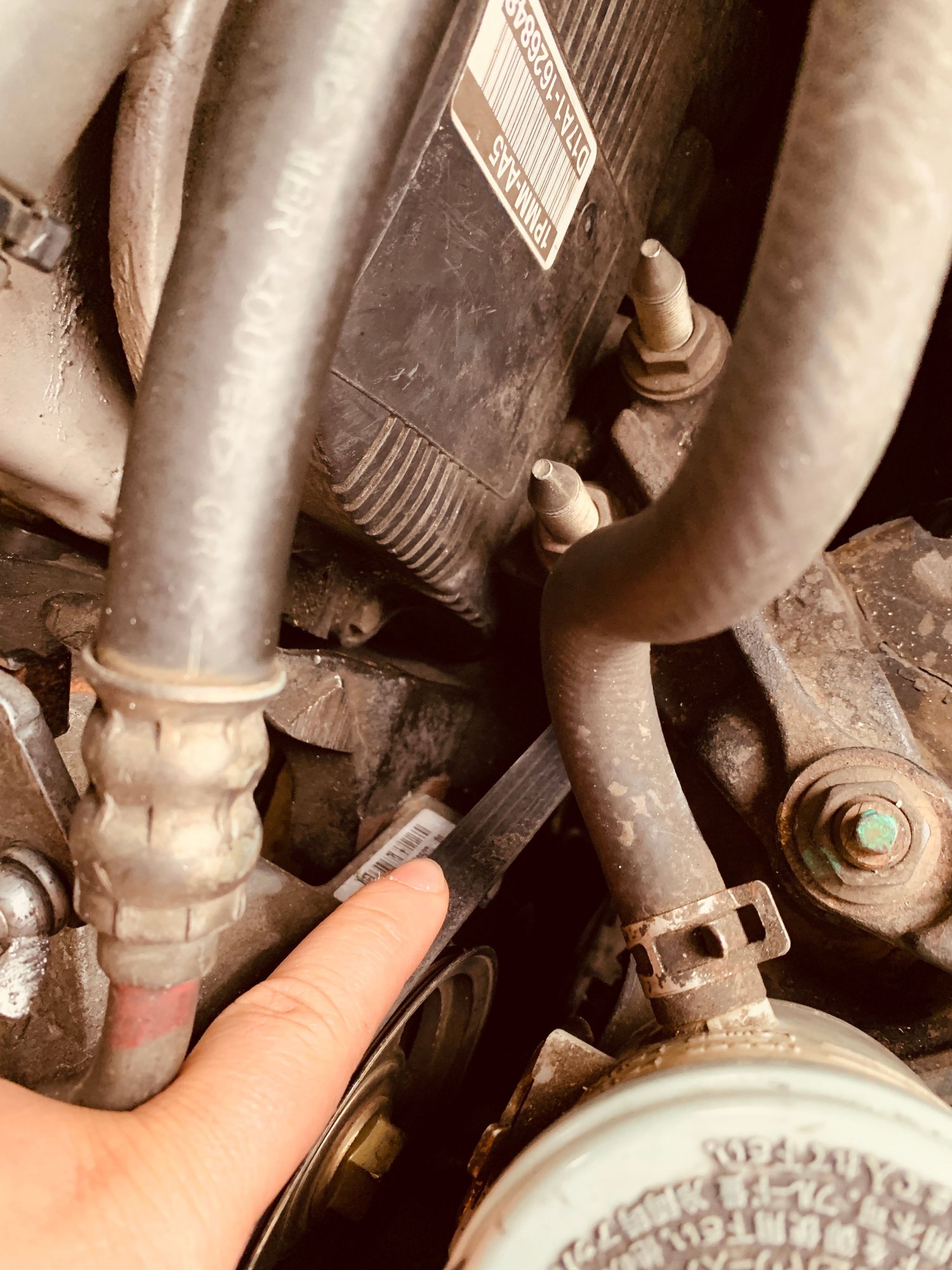

This belt feels loose

Sadly, as time, gunk, and corrosion works it’s way onto the mounting points, the alternator can “loose” it’s mechanical grounding to the engine and that then results in the ECU being damaged.
Mostly properly torquing the bolts seems to avoid the issue, but we see lots cases where the adjustment wingnut was tighten, but the two main bolts were not fully tightened down and pop goes the ECU.
We have seen many, many people on this forum have that happen to them, because you would never “think” a loose mounting bolt would kill a ECU, but it can.
Before putting a “third” ECU on, good option is to remove alternator and sand bolts and mounting points back to shiny metal, best option is to do same and also install an additional ground cable from alternator body itself to the front frame.

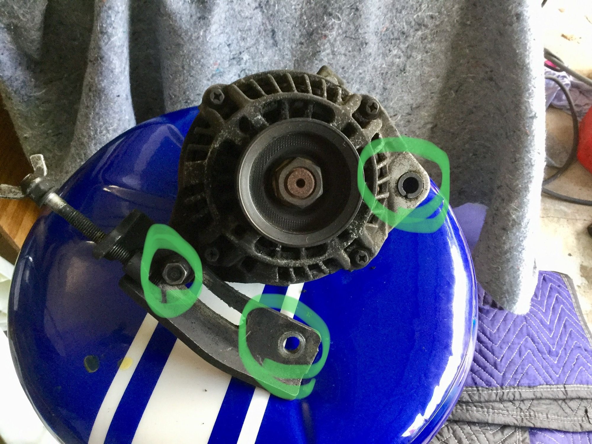

The “OTHER” bolt of the opposite side of the adjustment bracket.
All three circled bolts need to be clean and tight.

The top bolt does not make a ground connection, only the lower two bolts need thoroughly cleaned. another thing to check would be the engine/trans to chassis grounds. Also the power cable on the alternator as well as the other connector on the alternator.

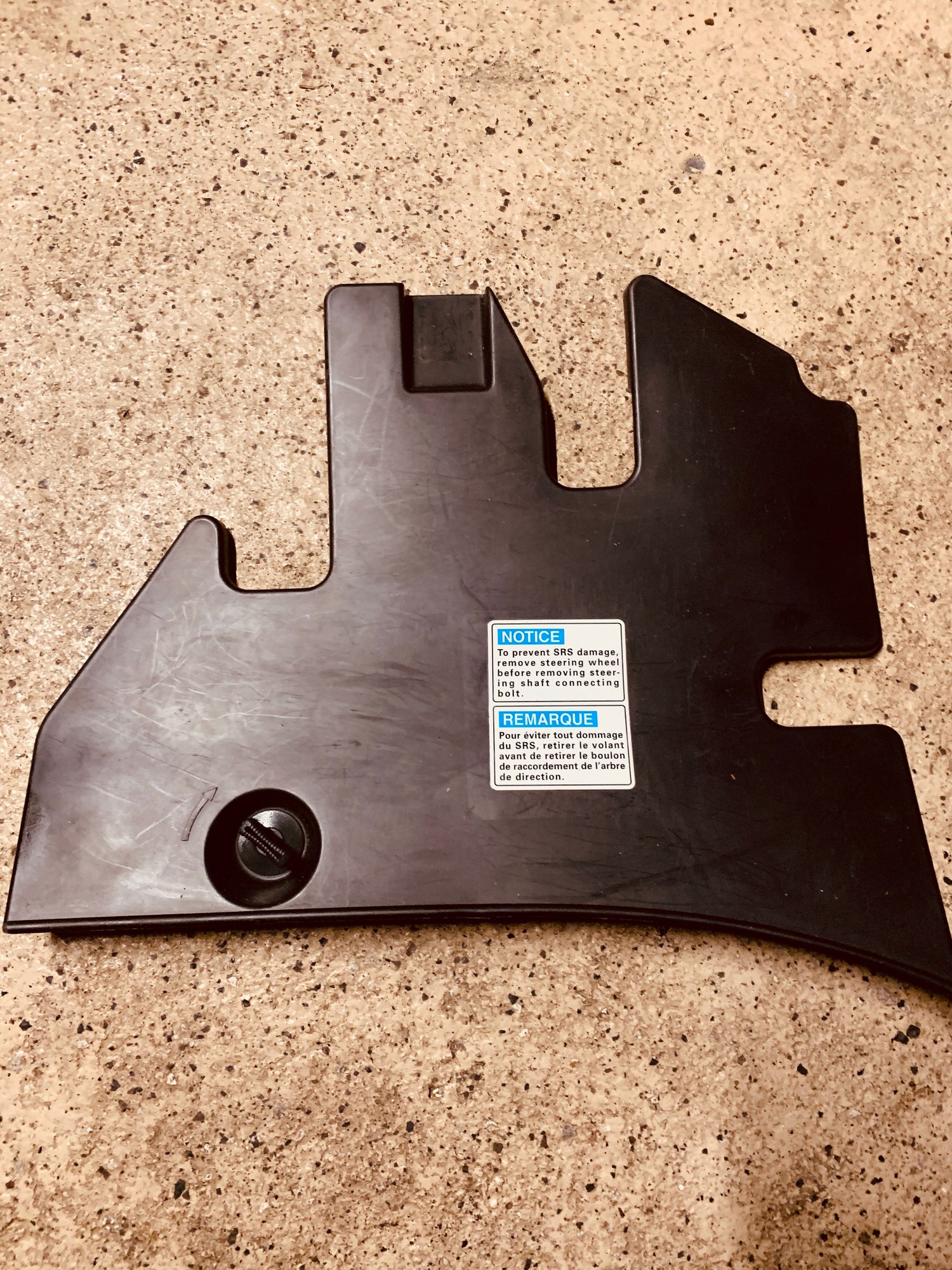

I put in the ECU and immobilizer that I bought original and started to troubleshoot using the service manually and funniest thing happen, the car started! Didn’t do anything different then last time. Thank you for your time and knowledge, one last question where does this go? Lol

Good to hear. That is the driver side kick panel. It goes above the accel/brake pedals.

Yes that panel goes on the bottom of the driver's side dash. Flip it over, slide front groove into the white plastic V, push up on clip on the left and then twist to **** into hole on the right.
