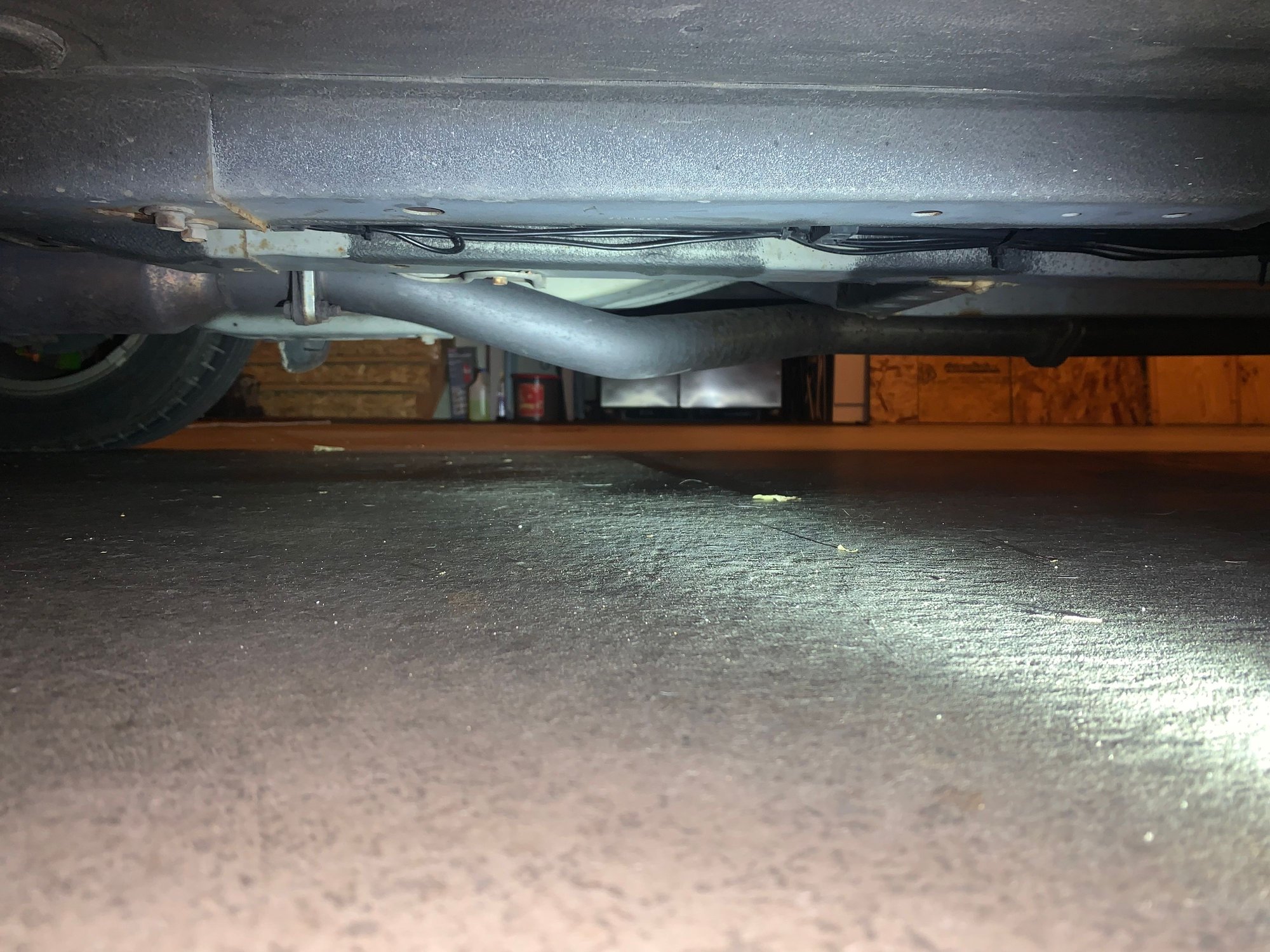

I am about to buy some coilovers although I have a catback exhaust sytem and right after the cat the pipe dives down and to the left leaving it about 3-4 inches more lower than the frame. Is there any suggestions on how to over come this or reroute it?

Pics?

Yes here.

How much do you plan on lowering? If it's like 1-1.5 inches, you might be able to get away with it. Any more and I'd get it rerouted. A shop might be able to custom fab the midpipe there?
What exhaust is on it? What kind of coilovers are you looking at getting?

Spec d exhaust catback. I mean yeah I could do about 1.5 inches but I live in indiana and potholes/roads and stuff is impossible to avoid so just seeing what I could do. I’m not sure what type of coilovers I’m getting yet. Just starting to look but this is my main concern before anything.

that bend is... wrong.
are the flanges welded or can you turn it?

The flanges are welded on the pipe its self but the flanges bolt together

Do this.
an exhaust shop can do it

I am on A budget here. I take a vocational that has a tube bender machine so I might by some and try to reroute it but the problem is where to put it because it can only go to the left plus I'd have to weld my own flanges.

cut around the bends and weld new piping.

That’s what I might do. My other easier option is to heat it red hot then bend the slope up as a safer option but we will see

That won't work, cut and weld
