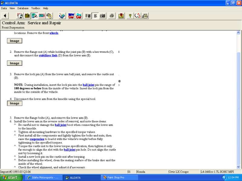

So here is my stupidly idiotic question: I was reading the guide here:
https://www.civicforums.com/forums/1...e-bushing.html
When I got to the last part about reinstalling the new LCA, ("Be careful not to damage the ball joint boot when connecting the lower arm to the knuckle") I was a bit confused, and even after searching around, haven't found an answer to my question: Do I have to pop the ball joint "out" or mess with its seating on the knuckle in order to swap out the LCA? Or am I able to just leave the balljoint alone (if its still good) when doing the LCA swap project, aside from just removing/reinstalling the castle nut during the process and adding a new pin after? The guide makes it sound so simple, but I would like some verification from more experienced DIYers before taking my sh*t apart.
I know what most of you would tell me, that its better off to just swap out the balljoints in the process. I was thinking about it, but it may be out of my abilities and time schedule right now. I did take the incentive to order some Beck Arnley balljoint parts along with an impact wrench + appropriate socket kit off Amazon, so I will probably tackle the balljoint replacement soon after.
Many thanks for responses in advance.

You DO NOT need to remove the ball joint out of the knuckle in order to remove the LCA. If the ball joints are good then they can stay where they are. Just be careful when you remove the LCA from the ball joint (held on by castle nut) because you could rip the boot.
I had to remove my whole hub assembly and take it to a shop to have the ball joints pressed out. I was unable to get them with a rental hand press from Autozone. Its worth a shot though since you all ready have the LCA off.

came late, but just for the sake of any other members coming here, the ball joint is the link between the LCA and the knuckle.
to change the LCA, you just need to remove the ball joint from the LCA, no need to remove from the knuckle (which requires a lot more effort and tools than removing the LCA)

If you follow my ball joint DIY part ways You can easily disconnect the ball joint from the LCA. After that it's just two more bolts and the LCA is out. After that you can either take the LCA to get the bushing pressed or you can come up with a way to do it yourself at home.
