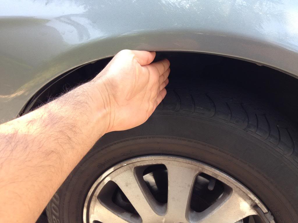

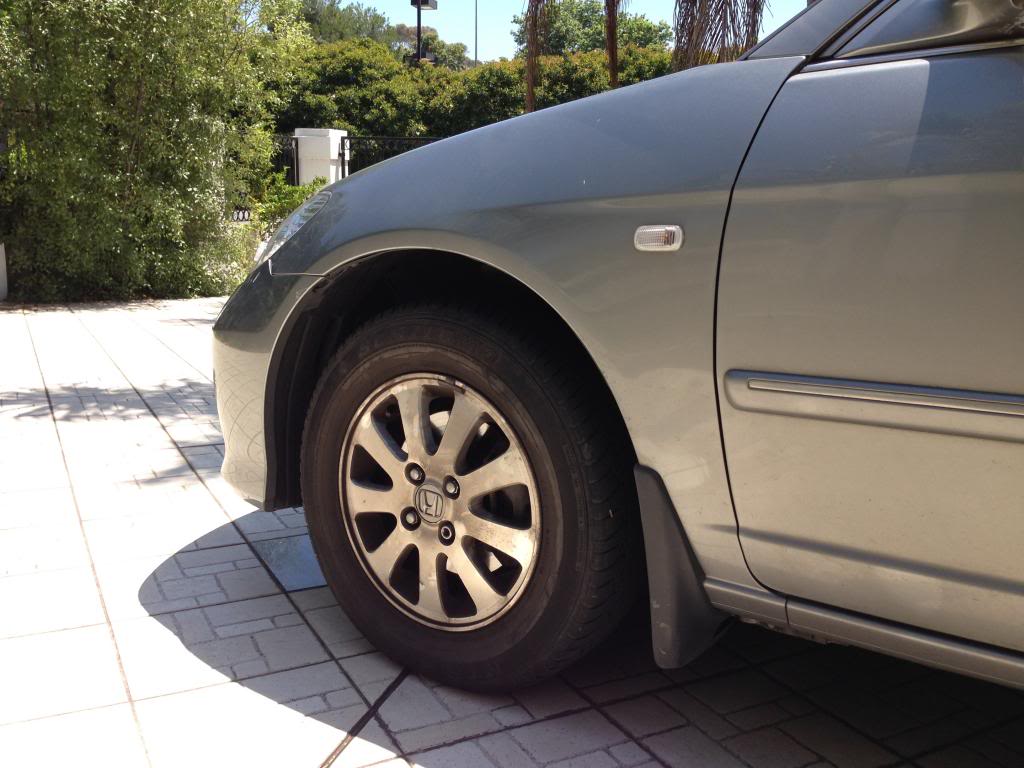

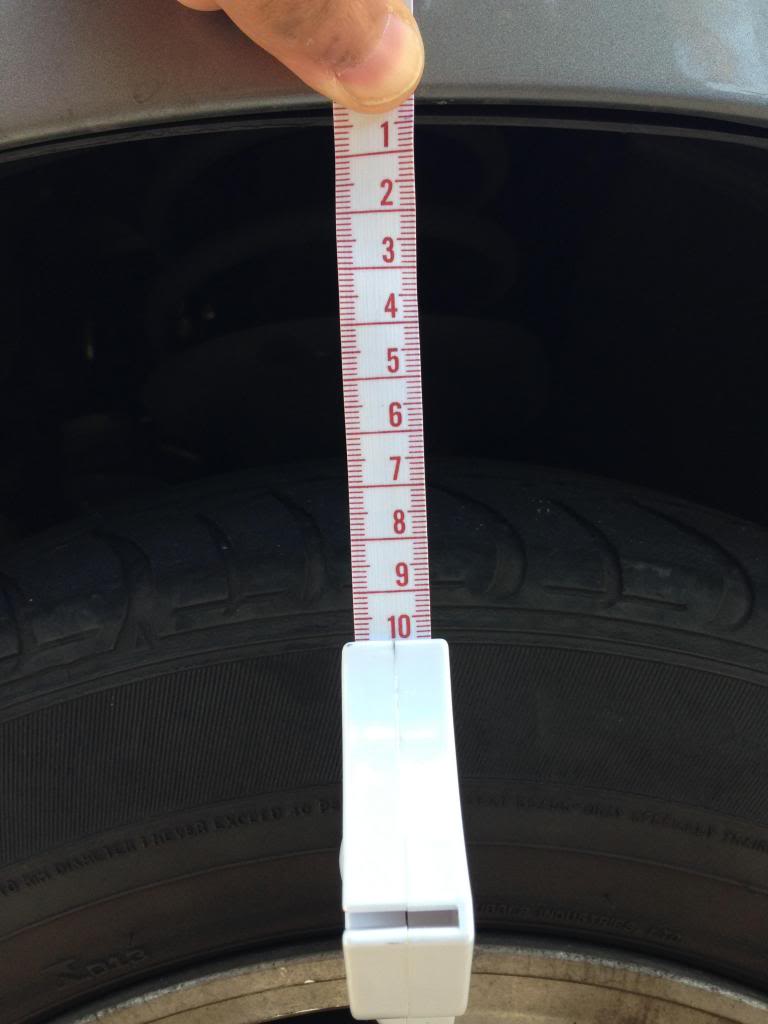

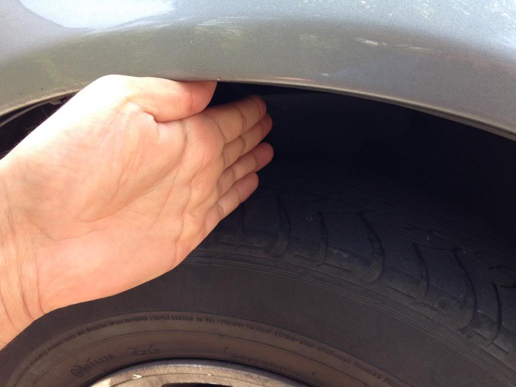

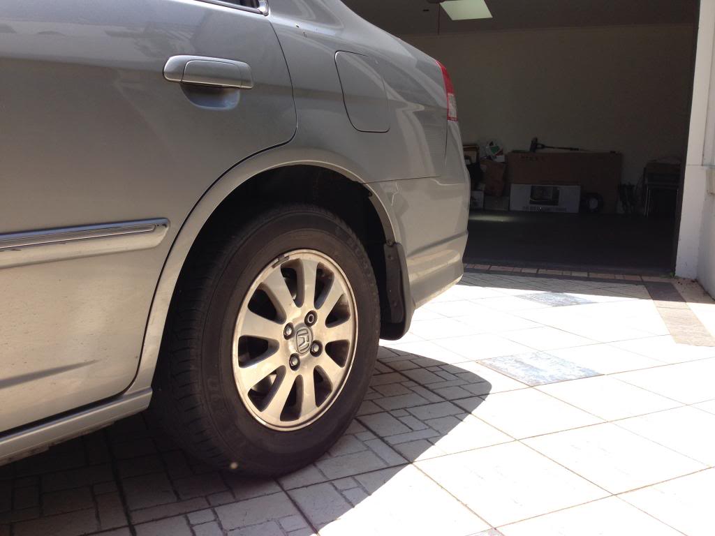

Here are some photos of the car
These are some massive wheel gaps
Can easily fit 5 fingers between the fender and wheels
About an 85mm (3.35 Inches) wheel gap
